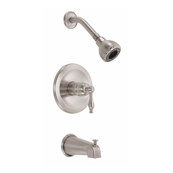

Yeah, the trim is Danze Sheridan, brushed nickel. See spec sheet:
Zoom in on the photo and you can see the hot / cold font is the same.
That’s the one! Same shower head even. Thank you.
