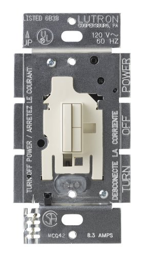

As goose134 stated, most dimmers can dim up to 600 watts safely, which is 10 60W incandescent lights. The dimmer itself (the ones I deal with) have tabs that can be removed, removing all of them would lower the watts the dimmer can handle. You can see an image http://ecx.images-amazon.com/images/I/41WzcqdK21L.jpg to see the "fins" I'm talking about. Notice there's 3 fins on each side (6 total), they can be removed in situations they won't fit, doing so reduces the load. This dimmer here at 8.3A can handle up to 1000 watts (it can control up to 16 incandescent 60w bulbs). However, I think it's more common dimmers with all fins intact can handle up to 600 watts, with 1 side removed 500 watts, and both sides removed 400 watts.

There is the other tricks I done pretty often with dimmers I put the metal switch plates on due they will act like heat sink as well that help a bit with dimmers.
