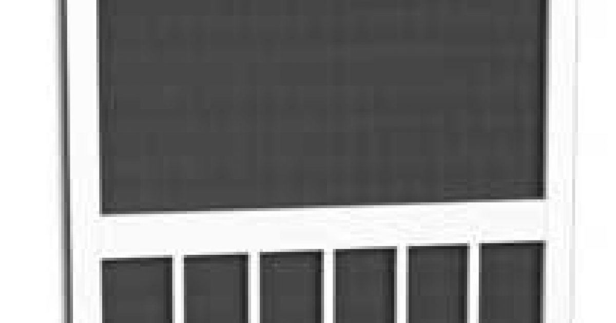

I found PCA doors- they seem like the level of door I want. I reached out to a local dealer to get a price.
