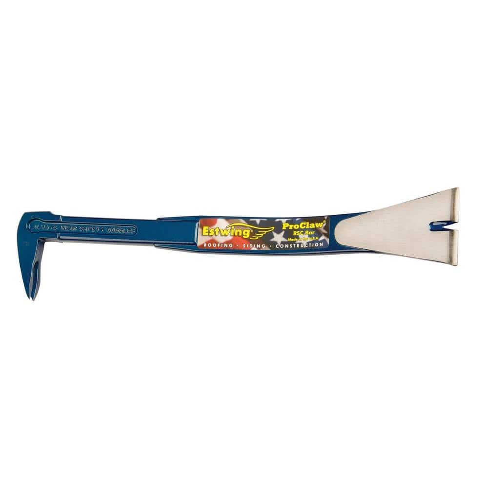

Deck screws are fine….because there is no lateral force. Save your $$. I would likely put in a 2 1/2” ring nail alongside the other nails. If any of orig pop above ply, pull out. Done. that said if you MUST pull, the one shown prior is crap. sorry, bold by mistake. most alll mfgrs. Make one with narrow claws at each end. Better choice, less damage.

Pulling the few were a pita as you said. A lot of squeaks in this floor and other rooms. The spiral nails seem to be working themselves loose, many are proud of the surface.
