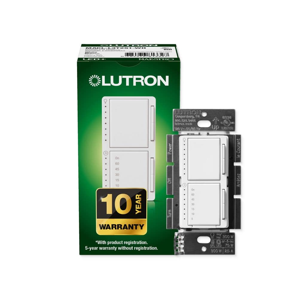

I am looking for a singe device to control two light fixtures (same circuit).
I have two requirements:
(1) I need both lights to be dimmable, and fit into the space of one device. I don't need it to be smart, and I do have a neutral in the box if that matters. I found this switch that seems to be able to do this, which is the Lutron MACL-L3S25H-WH:
Maestro LED+ Dual Dimmer and Switch, 75-Watt LED Bulbs/2.5 Amp Fans, Single-Pole, White (MACL-L3S25H-WH)
However, it says it can "dims 75-watt LED bulbs". The problem is, one of the fixture is a two lite fixture and each lit can accept up to 100W so total 200W. I wonder what does the 75W LED limit means, does it mean it may not dim correctly and using a higher watt bulb will result in less than optimum dimming, or will it actually overheat?
(2) The second requirement is that I need the switches to be vertically stacked. In other words, it needs to be a top switch/dimmer and bottom switch/dimmer and not a left/right configuration like the Legrand LSCLDC163PW Pass & Seymour Dual Slide Fan Control and Dimmer below. This is because the two fixtures are arranged such that one is higher one is lower.
Does anyone know of another device which has two dimmer switches that are top/bottom stacked and can handle 200W lights?
I am not sure, that was not clear to me whether it meant 75W LED or 75W "equivalent" incandescent.
It says "Dimming load works with 75W LED bulbs or 300W incandescent/halogen bulbs; on/off switching load works with all bulb types or up to 2.5A fans" so does it mean I can put that one a fixture that is less than total of 300W equivalent incandescent light, for example, a bath vanity light of say 4 incandescent bulbs of 60W each = 240W total would be under the limit of 300W, but for LED, two bulbs of 100W equivalent is OK? I got confused with the "75W LED" wording.

What you linked to is a dimmer with top ON and bottom OFF switches, NOT a dual switch. The only one I see that has two controls is for a dimmer and timer.
But, back to the question you had, if you had 75 watts of LED that would be a large lamp conglomeration since most are 11 watts or so. Meaning you could have 6 lamps at 11 watts and not exceed the switch.
60 watts LED equivalent is 8 watts
75 watts LED equivalent is 11 watts
90 watts LED equivalent is 15 watts

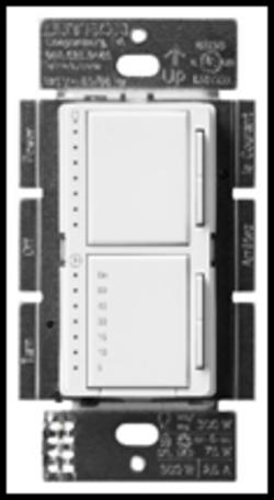

OK I found one but it's for incandescent fixtures.
The Lutron Model #MA-L3L3.
It appears to be an older Maestro switch, dual switch, stacked vertically, dual dimming, BUT it no longer seems to be listed on Lutron's web site but still listed on other web sites where half of them showed as "discontinued" or "out of stock" so this may have been something that Lutron no longer makes, I thought there should be one for LED but couldn't find it.
This obvious mean they are able to fit two dimming controls into the space of one switch even for 300W incandescent and halogen, they could make one for LEDs. What may have happened is they tried to make them "smart" and that requires more room but in my case I don't want or need smart switches.
The issue is even if I find one of these it most likely won't dim the LED fixture correctly. The search continues.

You are right the one I linked is a fan light + fan dual switch. I think they have one that is dual light dimmer that looks the same but I can't find it now, in any event it doesn't work with my vertically stacked arrangement.
It looks like the only one I can find that is designed that way is the Lutron Masteo MA-L3L3 switch which appears to be discontinued but still new old stock can be found in limited supply. However the issue is that it's for incandescent bulbs so if I use LED bulbs the dimming is probably going to be less than optimum.
Either that or I stay with the current stacked double rocker switch with no dimming.
