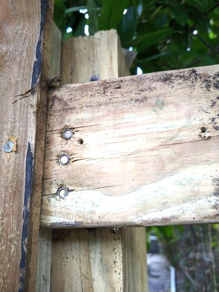

Possibly. I did try to hammer a socket onto it, but it was too deeply embedded, and the hex was a bit rounded from being driven that deep, it's a 4" screw. It just didn't have a chance of loosening unless the socket can fully bottom onto the head.
Wish I had a 5/16 or 3/8 hole saw. The other thing I could have tried, but didn't come to mind until later was to take the socket and shave the outside with an angle grinder so it becomes a "hole chisel" that can be hammered in to free the wood around the head.
Even if you could get a socket on there, the heads
would probably break off before they'd turn out.
A guy's gotta weigh out what his time messing around with stuff is worth.
I'd be inclined to just cut the boards out and replace them.
What are we talking about, three 2x6s?
Just cut 'em off as close to the screws as possible,
then start hammering down on what's left.
The remaining wood would break out in chunks,
then you could break the screws off easily.

Yes I end up chiseling the 2X4s around the screws to free the screws. I had 18 screws to free. By the time I was done I had badly damaged the 2X4 rails. That prompted me to have to replace the six pieces of the horizontal 2X4s, but that can't be done unless I remove each pieces of the 4" pickets nailed onto the 2X4s until I get to the next post which is 4 feet away. So all in all in order to free those 18 screws it's removing an additional 24 pickets and I damaged half of them because they were also nailed in to the rails and do not pry out easily. It's already done and I am on to the next repair but wish I could have cleanly remove those screws.
They're the wrong screws because the heads are wrong for the application. Those screw heads are designed to sit above the surface of the material. A countersunk screw head design is what you want here - beveled like a drywall screw so it can sit flush or below the surface. Trying to drive a flat head into wood is either going to crush the wood or strip the hole if you drive too hard. And it's kind of hard to understand how the guy got the heads countersunk in the first place using a hex driver, if the OP can't get it out. Hex drivers are not designed to countersink anything. So both the head shape and drive type are wrong in this application. A better screw would be a beveled (countersunk) head design with a star drive, for example if you want something overbuilt but with the correct design
Hate to disagree with you but my log home is build with countersunk hex heads about 500 of them. The ones in the picture are probably ledger board fasteners and are made to countersink, they have a taper under the head.
Good 5/16 hex driver, lots of pressure and low speed with a impact.
Well you really haven't said anything to disagree with. If a screw has a countersunk head, then it's meant to countersink. If that is the case, then one of two things is going to be true. Either it's intended to countersink no farther than flush with the head rim (not the full distance of the hex head, or if it's designed to countersink an arbitrary amount than the rim will be wide enough to facilitate the hex driver to any depth. The scenario in this thread is NOT how the screws were designed to be used.
Why would you have to replace the rails use a dremel to clear out around instead of chisel then flip the rails over when reinstall as from the picture the back side of rail appears to be against the post so flip rail hide mess against post
Discussion starter · #36 ·
This is a very old thread.
The reason I needed to free these rails was to lower the entire fence section a few inches from the post. This is why there are 18 lags to remove, 3 rails, 3 lags on each side of each rail.
I cannot just "flip the rails" over is because there are like 14 pickets nailed onto the rails, so flipping them over will mean turning the fence inside out. Besides appearance it not a factor since the rails are covered by pickets.
I end up using a wood chisel and free the heads, in the process some good size chunks came off, you can see the lags were driven such that the ends of the rails were already split. I came to realize that even if I could nicely and perfectly free five out of six rail ends if I only mess up one end of one rail, I still had to remove all 14 pickets from that one rail and those pickets were driven in with ring shanked nails and cannot be removed without destruction of the pickets. Which was what I end up having to do.
