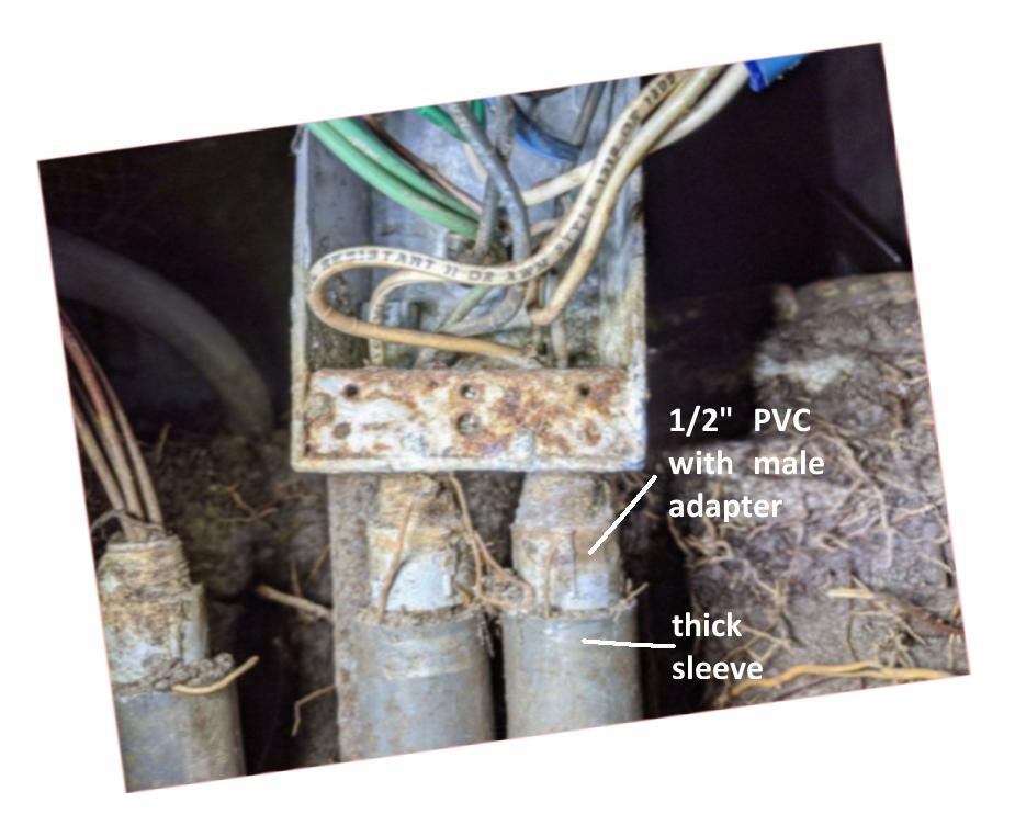

I have the cable cutter and can use it to cut the PVC conduit. However the challenge I have is how to cut the 1/4" thick sleeve outside the PVC conduit. I need to cut the sleeve lower then cut the PVC higher to have enough room to connect to a PVC fitting, and the two sleeved conduits side by side with very little room in between makes it even more difficult.
I would try it on the sleeve. If it doesn't cut it, then you might try an oscillator tool with a fine blade. Go slow and only cutting through what you need.

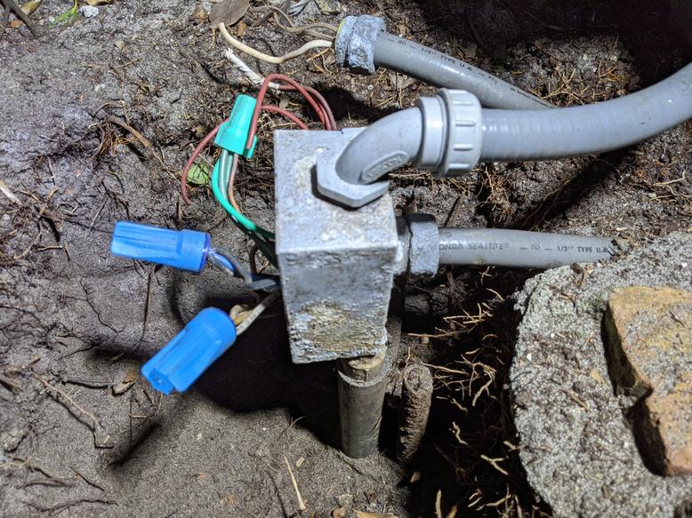

I made a bit more progress and would appreciate some further guidance.
Firstly, in order to do this hand hole thing I need to remove the existing badly corroded box, and there is no way to do that without undoing the existing connections inside the boxes. These connections were done with the blue wire nuts with silicone. So I took one apart and the ends of these conductors are all in this messy white gel. So, I assume with this gel coated, especially with stranded conductors, I have to cut and strip a new end, right? So if you use these silicone wire nuts each time you modify the connection you have to cut the conductors shorter and shorter? Are there other weatherproof connection methods that does not get this messy?

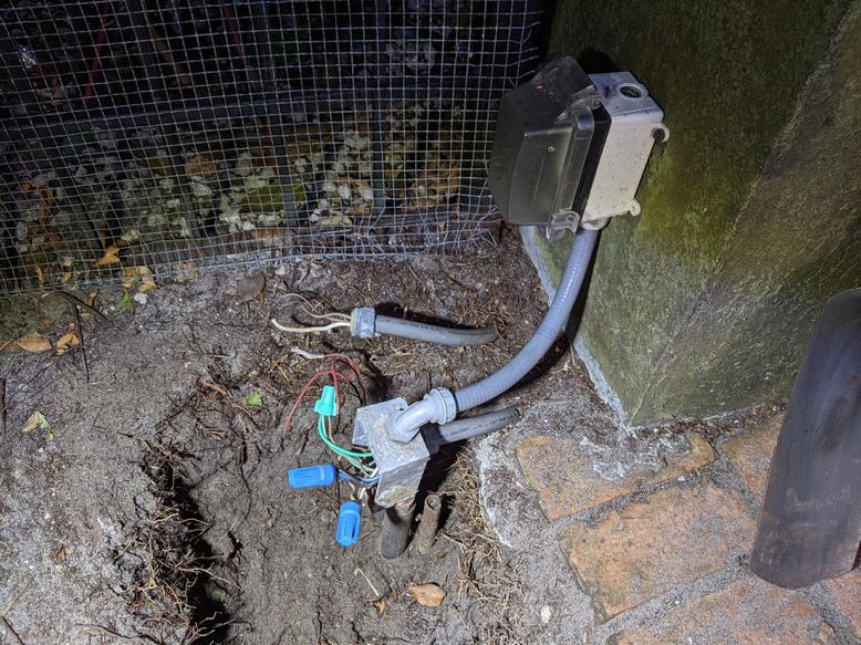

Secondly, I took all the connections apart and removed the boxes, and now I am trying to figure out how to make new connections with the hand hole. Here are two pictures with the boxes gone. In both pictures I labeled five conduits 1 2 3 4 5. Those are the five original connections. There was another one up top to a receptacle but that one I can easily add later.
Conduits 1 & 3 are security and intercom wires that was in one box. They will be completely abandoned as I will go wireless with that. That leaves conduits 2, 4, 5 to be spliced together.
My questions related to this are:
(2a) With the hand hole box surrounding all of these conduits, I can just make the connections with wire nuts inside this hand hole with no sealed bottom, just dirt (OK I will dig down a bit and fill in some pea gravel)? There is no need for me to cut out the existing PVC conduit's male adapters, or do any marine grade shrink wrapping or whatever to make it more weatherproof?
(2b) If you look at conduit #2, which is a liquid tight flex conduit that comes in higher than the other two conduits. If I put in say a 10" round hand hole box, that conduit #2 is going to be a problem. I do not have enough length to bend it down and back up, so is it OK to drill a KO hole on the side of the hand hole box for that conduit to enter? In other words, can I do something like this?

I got a small hand hole round box and did more excavation and this is as deep as I can get before running into concrete. Right now I have the box about 8" deep and 4" above grade. I also have concrete and bricks on the right side preventing me from centering the conduits in the middle of the box.
If not being completely flush with ground is OK then I am ready to put down say 4-6 inches of pea gravel inside to help with drainage.
Finally I still need to connect a liquid-tite connection that is coming in from the side instead of the bottom, I hope drilling a KO hole on the side of the box is OK for me to run that liquid-tite into the box.
