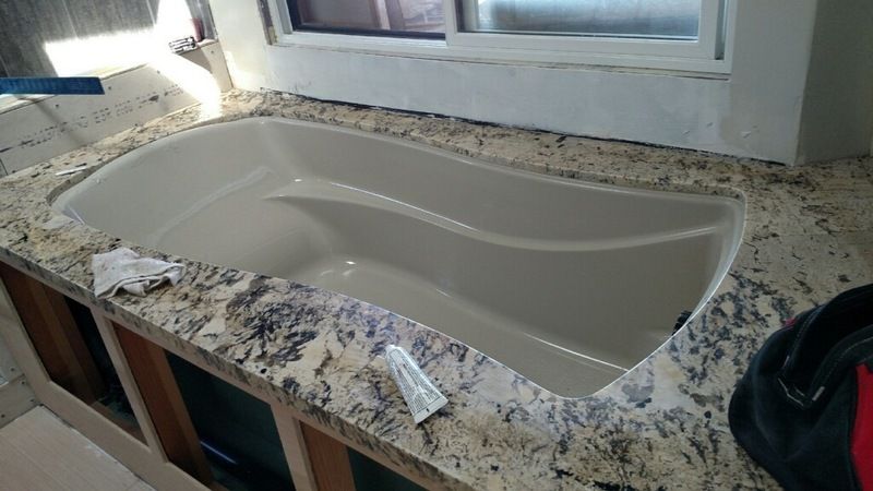

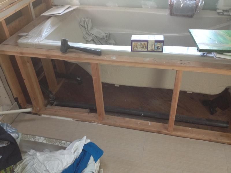

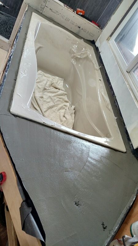

#29 ·
This is my wife's bathtub. Same basic idea. I built a nice strong base for it.
Granite guy floated a nice heavy mortar base around it.
And then set the granite slab using thinset between the mortar base and slab. I was concerned about the narrow points as well. It amazed me they carried this thing upstairs without it breaking. It's almost 9' long.
