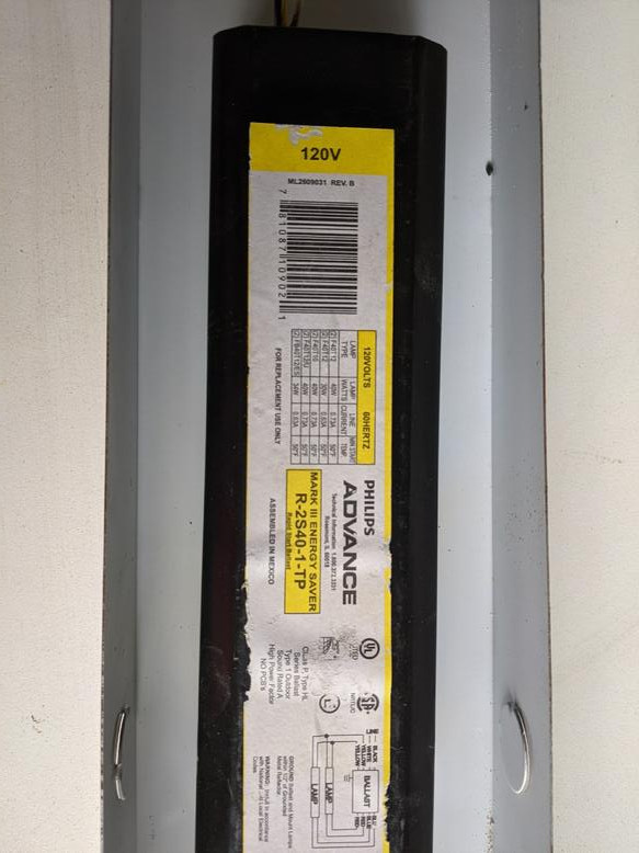

I have a standard fluorescent light fixture in the garage that takes two 48" tubes. It has a bad ballast. I removed it from the 12' high ceiling already.
I am trying to decide between three options:
(1) throw it away and get a new LED fixture instead.
(2) replace the ballast. It is a R-2S40-1-TP ballast.
(3) I understand that I can remove the ballast altogether and just use regular 48" LED tubes. However I am not sure how the wiring would need to be modified. This is a picture of both sides of the fixture. On the left side I have two yellow conductors coming out to the ballast, and on the right side, I have two blue conductors, and two red conductors. The switched hot and neutral are connected to the ballast. How would I remove and bypass the ballast?
I am leaning against replacing the ballast since a new ballast is about as expensive as a new fixture probably.

So my fixture is a "double ended" fixture requiring double ended LED tubes if I do the ballast bypass?
OK so now i have another question, once you do a ballast bypass and put the metal cover back to cover the wires and ballast (now removed), the fixture would look the same outside. How would someone unaware of the byoass surgery know what type of tubes to use with this fixture. Is there any sort of rules to mark the hot and neutral end, and some other labels to say this fixture contains no ballast and not to put on regular fluorescent bulbs?

If I choose to replace the ballast, is this the ballast you would recommend?
GE UltraMax Proline Electronic Ballast, 120/277 Volt Instant Start Ballast, High Power Ballast Factor, Ballast for Fluorescent Light (2) or (1) Lamp T8
It seems most ballast wiring instructions on the body takes three wires, but my fixture has six wires.
