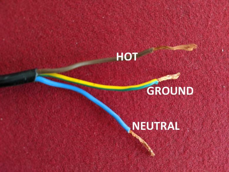

This is a European made light fixture. The end of the wire has brown, blue and green/yellow striped conductors.
Can someone confirm if brown is to connect to hot, blue to connect to neutral and green/yellow goes to ground.
Except for the code violation. Because it connects to the wiring (not with a plug & receptacle), it falls under the NEC. If I remember correctly, NEC 410 and/or 411 requires all light fixtures (luminares) to be listed.
An EC mark is not a substitute for a listing mark from a NRTL.

The NEC doesn't address sales or possession. Only what's actually connected to a wiring system.
A listing mark says that a disinterested party has tested to an
agreed upon standard and found the item to meet that standard. A CE mark involves neither a disinterested party nor any testing.
