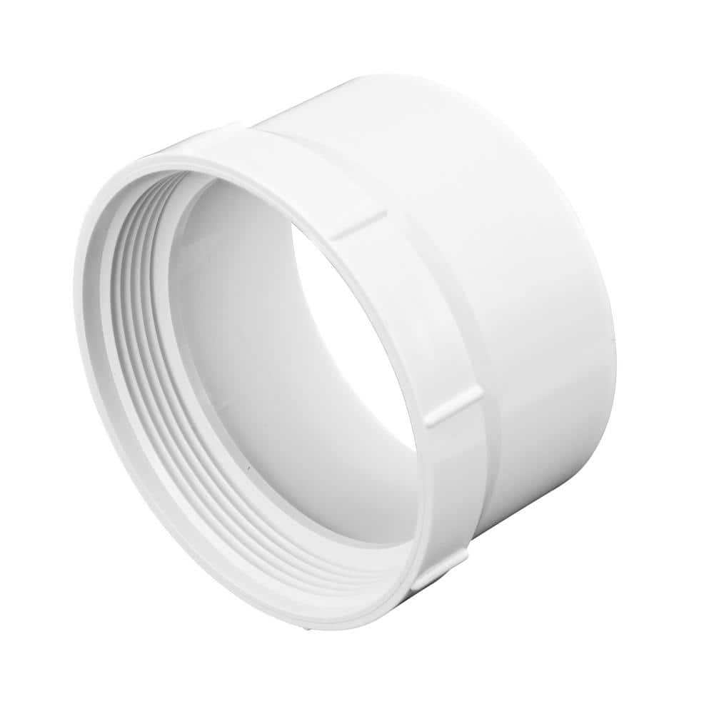

Downspout Adapter and wye cleanout material. This connects to 4in pipe so I need to connect this to the 6in main pipe from each downspout:

You have lots of choices for parts and ultimately how you lay this out, but sticking with Home Depot:
- Surface drains should always have a catch basin to collect debris. NDS-6-in-Plastic-Round-Speed-D, or NDS-6-in-Spee-D-Double-Outlet-Drainage-Catch-Basin, or NDS-9-in-x-9-in-Plastic-Square-Drainage-Catch-Basin. If you are connecting to 6" pipe, you'll need an adapter and can only use the square catch basins NDS-6-in-Styrene-Universal-Catch-Basin-Locking-Outlet-1266.
- Any change from 4" pipe to 6" requires a reducer NDS-PVC-S-D-Increaser-Reducer-Coupling-4-in-Hub-X-6-in-Hub. You'll also need a full suite of S&D fittings of elbows, 90d/long turn/45d/22.5d/etc like here S-D-90-Degree-Elbow.
- If you go with a pop up emitter on a 6" pipe, 4" is what is used in residential so you'll have difficulty sourcing 6", but here's the ndspro emitter-for-6-in-round.
- And again, you really don't need a cleanout at the downpout. The wye is huge, sticks up, and looks terrible. If you slope the pipes adequately, there will be little debris collection in smooth rigid pipe. If you need to rod, you can remove the downspout, keep the downspout adapter unglued, and you can rod right there.
