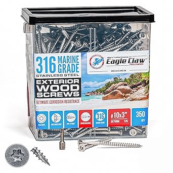

This is another option from Amazon. 316 stainless steel marine grade 3" deck screws.
