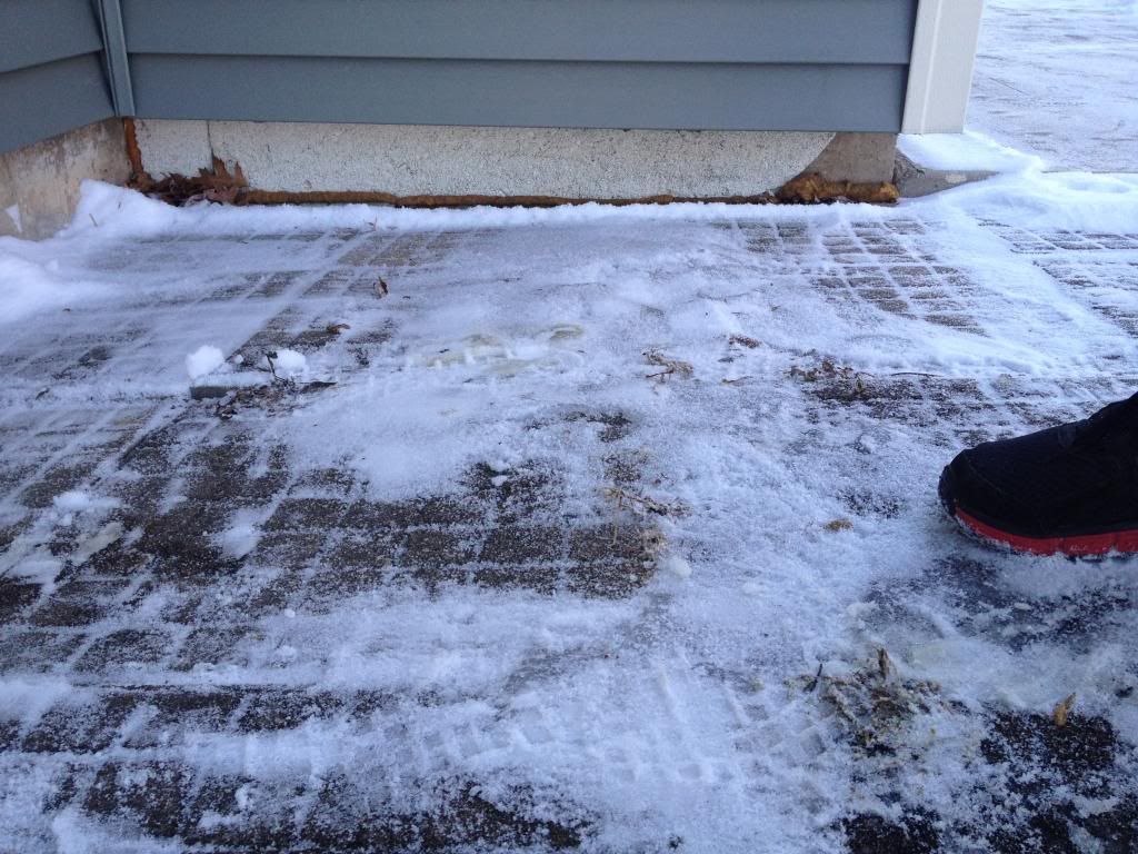

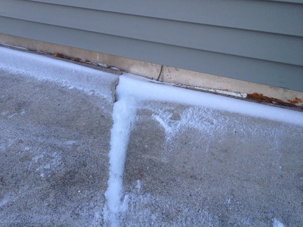

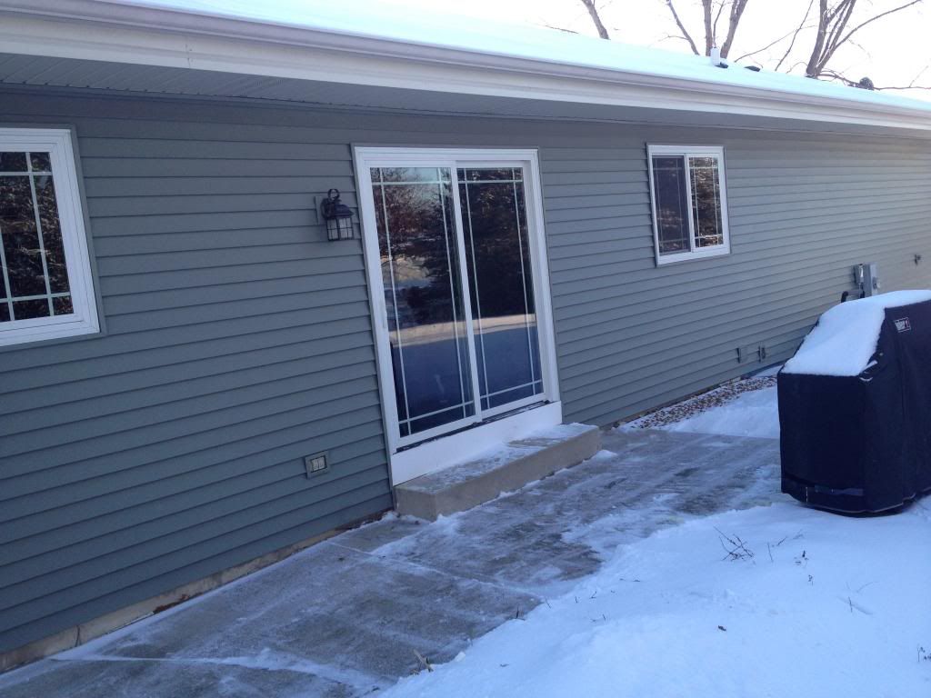

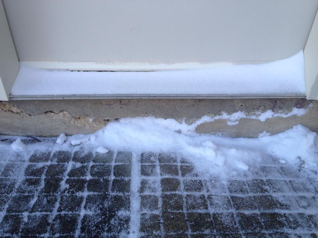

Ok, keep in mind I'm completely new at all this. When you are talking about the threshold, what do you mean?
Here are some pictures for reference...
This is pretty much the gist of it. I didn't shovel everything but you can get an idea of what I'm up against.
This is one of the many cracks and you can kinda see how it is basically making a nice tunnel for water to flow right to the house

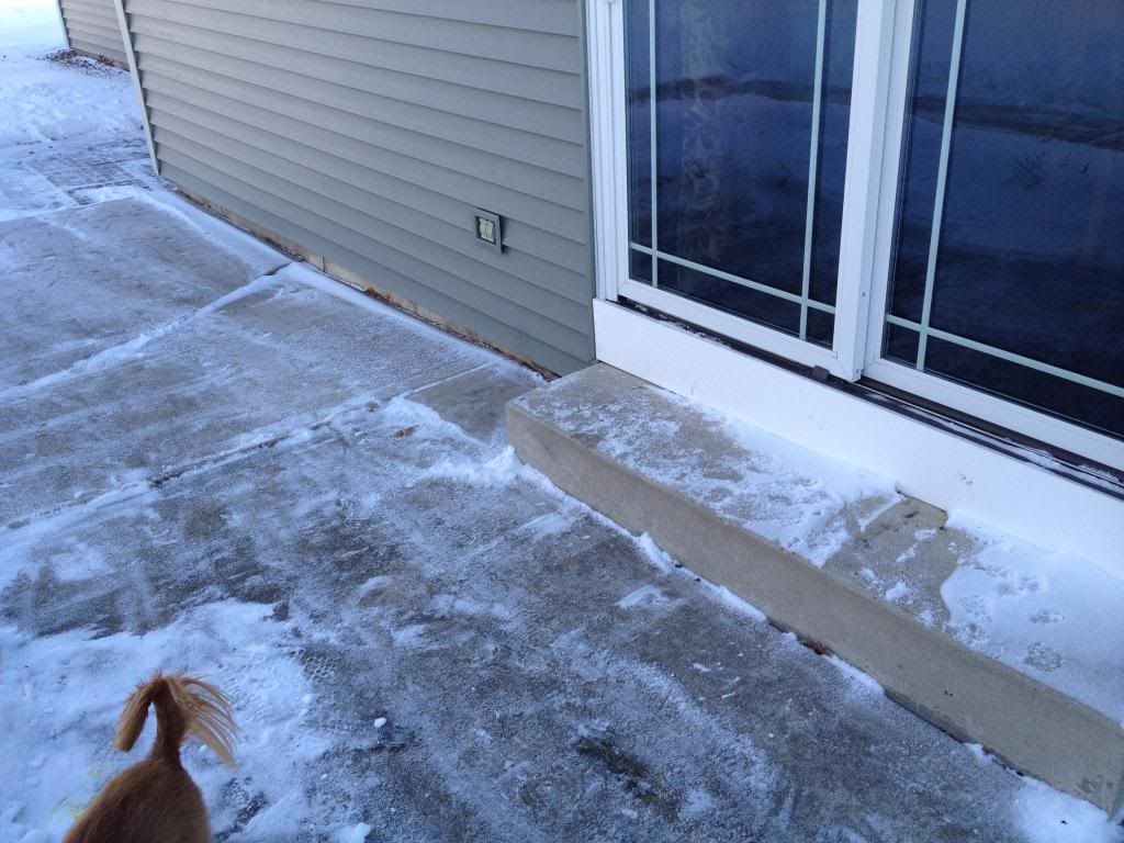

There seems to be about an inch of foam between the concrete and the foundation and looks like someone tried to fix some of the issue with expanding foam as well.

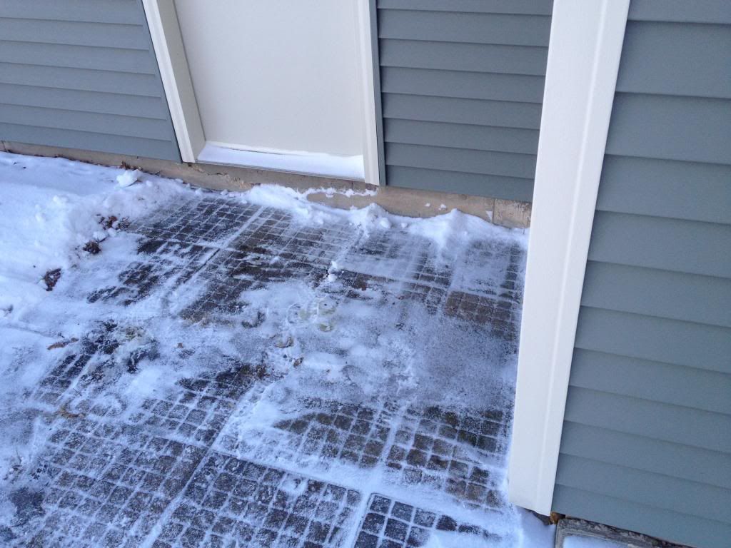

I also have a door that leads in to my garage with some planters put down leading to it. The grading here is especially bad. And somehow, even with the door sill about 8 inches off the ground, water tends to seep through and run in to my garage. I'm not sure if its the crap concrete underneath or what.
There's some snow in it, but you here you can see the concrete basically falling apart under the door
This kinda shows how bad the grading is. There's about a 3-4 inch difference in height between the left and the right sloped towards the house.

No way would I be considering installing any type of deck on that style home.
It's already to low.
Go with a patio instead.
The main reason patios fail is the ground under them was not properly prepped, just removing the grass and poring over it is not going to work.
Both your doors were not installed right is the reason there leaking.
I'd bet there's no flashing under them, the one in the garage has nothing under the threshold to fully support it so it does not twist when stepped on.
The one on the house has a piece of something over the outside edge of the threshold instead of under it to support it so all it's doing is forming a funnel to direct the water behind it.

Couple thoughts here:
- The back landing at the patio door is sitting on "haunches" more than likely, and it takes a little more care in removing if you go that route. If you end up replacing with another patio, you may consider keeping it if it's in decent shape.
- I can see no way that rain is coming into the garage service door from BELOW the door, it must be coming in OVER the threshold somehow. Perhaps it's running down the J channel and leaking in, or something similar.
- Although this time of year seems like a great time to tear-out the patio due to the frost, I wouldn't suggest doing so. The patio is frozen to the ground, and will take the subgrade/gravel/frozen ground with it. Removal will take 5-10 times longer than it would when the ground wasn't frozen. The only way around it would be to use insulating blankets/etc... over the patio for a few weeks before attempting to tear it out...........

Looking at your photos you have a problem. Have your guy tare out the old concrete, it looks as if you have some brick pavers in there as well never the less if your not going to save the pavers have him remove it all.
Next in the spring or when the ground is has thawed out form up the patio that you desire. Making sure that water will run away from the house. REMEMBER 1/4" in 4' is the rule of thumb. Meaning from your home the the form must be picked away form the home for every 4' it must drop 1/4" if you get more that is OK. It is NOT TO BE LEVEL.
Use 2 x 4 for forms once formed bring in some fill 21 AA crushed concrete for your grade to fill in the low areas. Form the looks of it you will need no more the 2 yards of fill, being that you are going to put back 4" of concrete. From the top of the form down will be your slab.
Your step area remove the board under the door well, you can replace it after the step is repaved. Form the step split the difference between the top of the door wall thrush and the top to the concrete slab that you are going to place. USE A STRING LINE TO DETERMINE THE BOTTOM OF THE STEP-- (You can put any kind of step in at this point) half round, 14 or 16 " landing step. You could even extend it even further then the door wall so that floral pots can set on both ends. LOTS TO CONSIDER WHEN IT COMES TO REPLACING YOUR PATIO
Make sure you tamp the new fill before placing concrete
to make concrete stronger use wire mesh, rod for the step, and fiber mesh these materials will help keep it from cracking and spreading apart.
Your patio may have settled over the years and that happens or the fellow that placed it in the first time did it wrong. Just remember concrete does not bow like a wood so if your concrete is bowed toward the house-- well you make that call..
THE FINISH- Light broom is nice, or swirl like a stucco look, borders on the outside edge look great ----- and saw cuts for relief cracks --- just remember all concrete cracks.
Hope this helps if you don't do concrete get someone that knows and does it. This is not something you want to practice on especially when you are place it, all the other things before that you can fix before placing. GOOG LUCK
