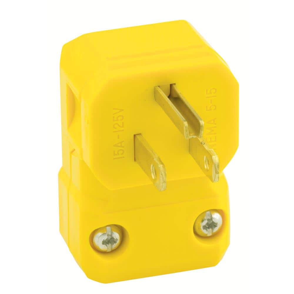

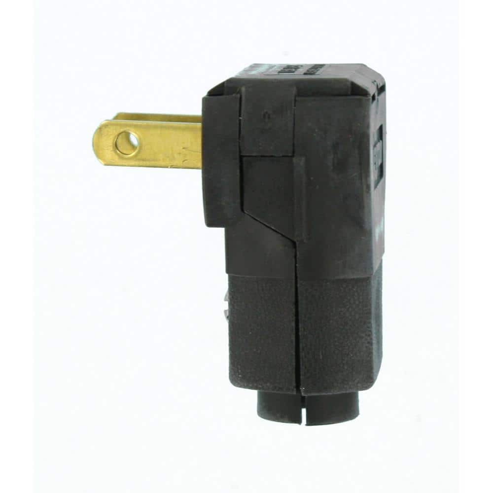

Can you buy a right angle plug?
7.3K views 54 replies 21 participants last post by  samjg1
I got a new TV and am mounting it on the wall. Problem is I don’t think the TV is going to be far enough from the wall to allow the plug to go into the receptical (plug is about 1 1/2 inches long ). Does anyone know if I can buy some type of right angle plug that I can replace the one that came with the TV with?would have to cutoff existing plug and retire with new plug.
thanks
Yes, but it may void the UL listing of the TV. Is the plug you have presently polarized two prong or three pronged?

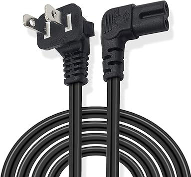

You asked about flat cord caps:
Emerson, GE, Samsung and others make flat cords to fit televisions and similar items. A photo of a sample is below. Be sure your female end matches the TV cord and that it is ULT, ETL or CSA listed.
Places like Lowes and Home Depot sell very flat extension cords. Some are so flat that they have a bail to grip for removing.

Home Depot sells extensions like this. No idea if this will help, but it should. Low profile, flat plug, grounded 3 prong.
Want a really, really flat one?
Sleek Socket sells the flattest I've ever seen. A photo is below.
There are other brands, but Sleek Socket is the only I know of with UL or ETL or CSA listing.
The female end can tuck into the hollow around the VESA mount or the back of the monitor. (Or even be zip tied to the top or bottom of the thick area where the vent slots are.)
It does come with Command type strips to adhere the female end to the wall or monitor, if desired.
They are a bit of a struggle to unplug, however. (Flat, plastic blade under the edge and wiggle.)

#52 ·
Yes, there are triple taps that plug into the wall outlet, fold flat against the wall, and have outlets on 3 sides - or you can buy whole extension cords that have a right-hand plug - I do recommend you use a great surge protector, made from some reliable company, and buy from a reliable source - so it is not likely to be counterfeit. I like to find cords that are at least 14 gauge wire (good for a full 15 amps) - though the new wimpy standard (only 13 amps) would probably do for just a tv. My understanding is that it is not only the big electrical surges that kill electronics, it is also the smaller daily "hits" that degrade delicate circuitry over time. I have usually used APC products.
