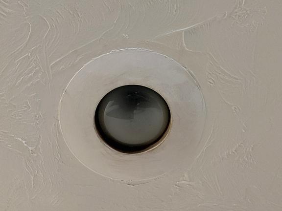

Trying to change out 12 recessed lights to new LED bulbs.
Problem is out of 12 lights, two of them won't back out all the way. I tried turning it counterclockwise to loosen but both turned about one revolution then it got stuck, won't turn anymore. Won't turn clockwise or counterclockwise.
I don't want to put excessive force to turn it for fear I would break the bulb and shatter the glass.

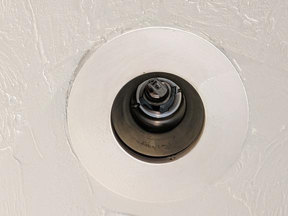

This is what the trim and can looks like, the trim has a built-in inverted cone, so removing the trim will not give me more room to grab the bulb.
Any idea what else to try? Tape the entire bottom of the bulb with duct tape then try turning again?

The ceiling trim is spring loaded. You should be able to pull the trim material down and remove it to expose the bulb. If you can't grip the bulb then borrow that rubber thing your wife uses to open jars. If that doesn't work get a roll of double sided tape. Attach a strip to the bulb and then remove the backing. That will give you a sticky surface which you can easily grip.
If you look at the second picture you should see the trim itself has a shape that kind of follows the contour of the bulbs, which means there is a narrow inverted cone all around the bulb. Yes it is spring loaded but the trim does not come off unless the bulb is removed. The narrow part of the trim is only slightly bigger than the socket at the base of the can. If I cannot remove the bulb the only other way to remove the trim is to break the bulb so the wider part of the bulb will not be in the way of the trim's removal.

I was finally able to remove the two bulbs. Ten of the twelve bulbs came out easy, the last two didn't. One bulb broke off, the other came loose as I twisted with all my strength.
I figured out what happened. These are very old recessed lights, and the socket is mounted on a piece of thin circular metal that slides up and down secured to the can with a wing nut. For some reason the wing nuts were loose so when I pushed up the bulb got pushed back along with the socket. When I tried to turn to loosen it got stuck, and the more I turned the more the bulb got pushed back further.
This is the trim I have. As you can see, the bulb hugs to it's shape closely with barely 1/4" of space around.
