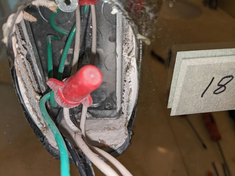

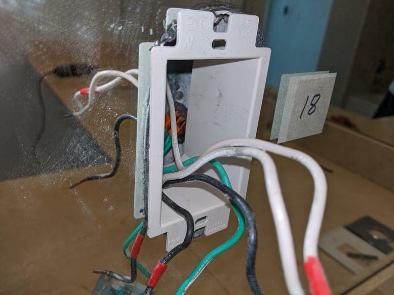

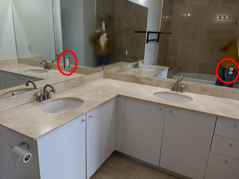

Existing bathroom GFCI receptacle, I just removed the cover plate to check the wiring.
The receptacle is on a mirrored wall that runs from across the wall from counter to ceiling. The box is a 4X4 metal box with a two gang one device mud ring. However the box is recessed like 1-1/2" behind the mirror.

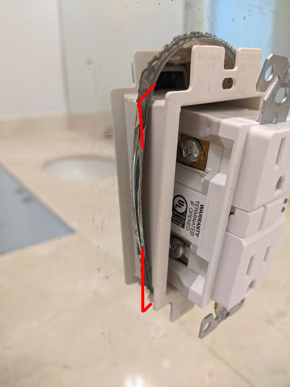

I would like to add a plastic box extender like this.
However, the hole is not wide enough to fit this box extender. It's close but the left side needs to be enlarged a little bit, shown below in red is what needs to happen.
What is the best way to give this mirror's edge a little shave?

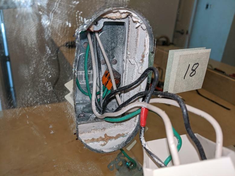

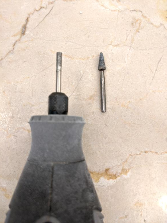

I have an 4.5" angle grinder with a diamond wheel...but I think it's too large a tool and too aggressive if I slip.
I have a oscillating tool, but all my cutting blades are for wood, wood with nails, sheetrock/plaster, I don't have anything that will cut mirror.
Will a Dremel work here? A conical grinding stone or a cutting disc?
I don't want to crack the mirror.
Of the tools mentioned, the Dremel will be the best one. Too much vibration on a multi tool, and a grinder....well, you know. You have the extension inside the hole, it appears. Leaving it on the outside would be fine. Can you do that?
#6 ·

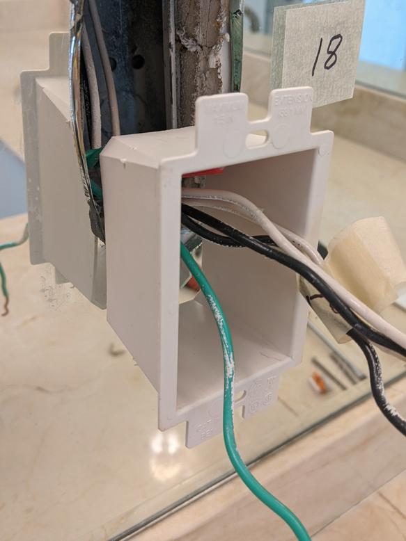

It's not going to make a difference if I leave the extender outside the box by trimming it. The extender is tapered and fits through the mud ring opening nicely but the widest outside will not bottom to the mirror because it is too wide (by a small amount). I think Carlon makes a blue extender but not tapered, so it probably doesn't even fit at all.
That is not a plastic box extender it is a plastic box.
None of what you propose is legal because your using parts outside their design parameters.
The right way cut a hole big enough to get metal box extenders back to the box. This will be ugly and a lot of 4 lettered adverbs will be used. Then have or find a mirrored cover for the outlet to trim the job out.

I will try, but the plastic extender is quite thin, may be less then 1mm so any removal will basically break it. But I will try with a Dremel first, I think I may have some engraving tips I might try on the mirror and see if it's able to just shave off a bit. I may shave a hair off the extender at the same time. If that doesn't work Jim Port's advice to split the extender is in my back pocket.

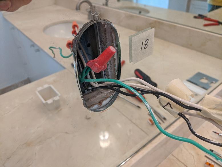

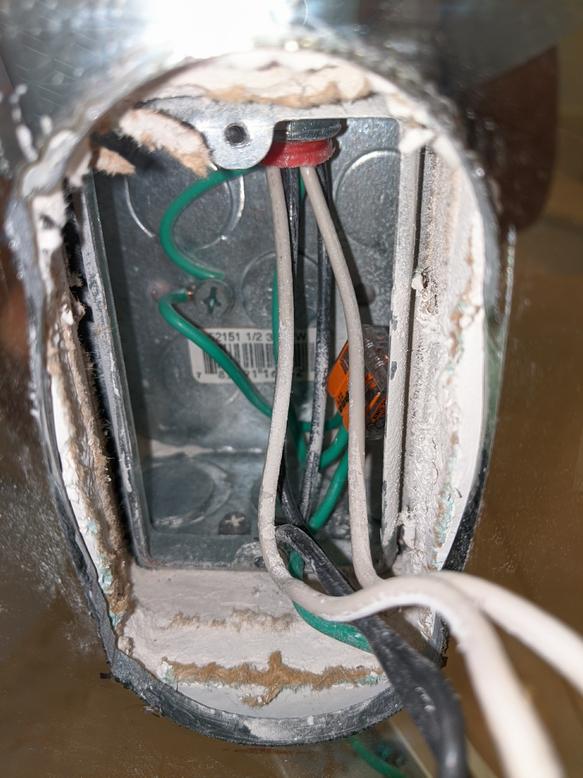

#19 ·
OK some good news. My plan was to give it a try on shaving the mirror's left edge at the corners with a Dremel. I have a cone shaped bit and a diamond bit.
Took some patience but it worked and I just needed a little around 1/16" or so. Here are the slightly shaved corners.
I was able to bottom the extender into the metal box mud ring opening.
