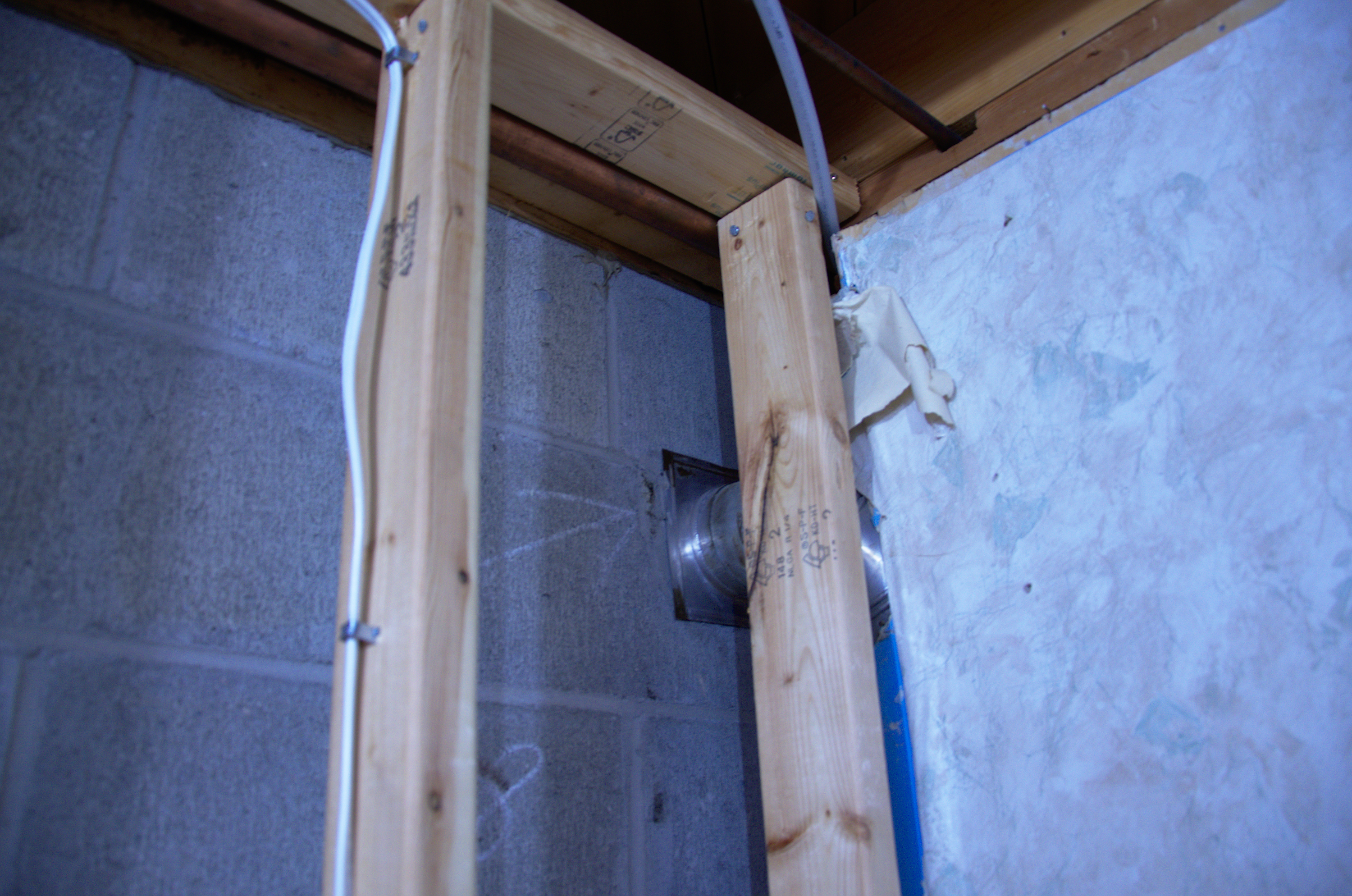

What is the best way to air seal the dryer vent, I am insulating my basement and using mostly roxul and will be spray foaming the areas where vapour barrier will be hard to do, such as rim joists. Can I spray foam the dryer vent? Seems like that could be a fire hazard right, or would it be fine? From a quick google search it seems that it would be fine but just want a second opinion. I suppose taping up the plastic to it is also out of the question as the heat will just make the tape come loose. How is this normally done?

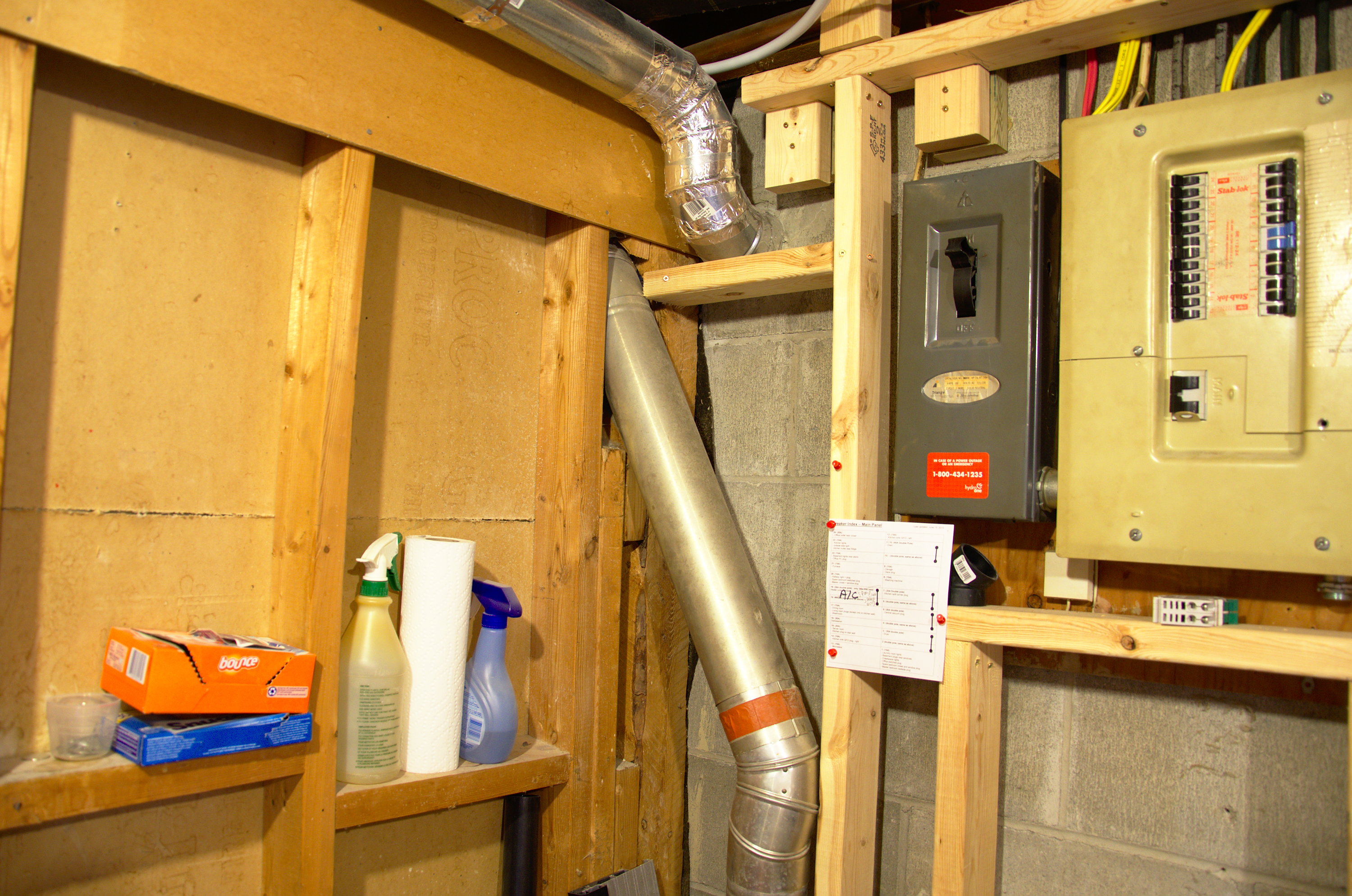

There's a wall that goes right against part of the vent, it's an odd setup, I'll probably be opening up part of that wall and rebuilding so that my vapour barrier can continue to the other side. Here are pics of both sides:
I might also omit this area for now as it will be more involved, but wondering how air sealing/insulating around dryer vent is typically done as even with a normal setup, you need some way to air seal that general area. Maybe just a metal plate, by the time it reaches the vapour barrier it would be cool enough as it acts as a heat sink?
Tape all the seams with proper foil tape.
Spray for for seal at the wall where it goes through. I would put a bit of roxul in the hole and spray over it so it does expand to outside.
I would spray foam where it touches the concrete or is adjacent, and roxul the rest.
So it's ok for the spray foam to be in contact with it? Since that is an awkward area to tape vapour barrier (for the inside part) I might just spray foam the whole thing then just vapour barrier up to the next 2x4. Then just tape the face of the 2x4 so tape is on the insulation too, that should provide a half decent seal. Going above and beyond ensuring everything is sealed as tight as possible, my upstairs is done terribly and I freeze in winter because of it so may as well do the basement as best as I can, so eventually I might redo the upstairs. That would involve taking all the drywall out, so a pretty messy job.
Basically I have a few of these "odd" areas that I am reserving for after I'm done foaming the rim joists, whatever I have left over in the canisters will go to these areas so I can keep using it until I run out. You only get one go at it so may as well make the most of it.
I might also move some of that pipe over a bit to make it easier to work around. Once I open up that side wall it will make it easier to route it better. That whole wall is kinda awkwardly built.

Did some cleanup with that wall to make it easier to tie in vapour barrier from one side to the next if I go that route, ended up being easier to just take that whole section of drywall out. It has wallpaper anyway, probably easier to redrywall than to take wallpaper off. :p
So here's what I'm thinking, I'm not comfortable having foam touching that pipe so I'll stick to a standard batt insulation + vapour barrier now that I made the wall easier to work with, but regular plastic would melt (or would it?), so for the section in red, I need to use a different kind of material that is heat/fire resistant.
(pic is a somewhat edited to take out the partition wall to make it easier to visualize)
Is there a product I can use as a vapour barrier for the red section, that won't melt from the dryer pipe? I'm thinking a section of sheet metal or some kind of heavy duty tin foil, but not really sure where to buy that. The reason I'm covering such a large area is that it will just be easier to tie in the regular plastic for the rest of the basement as there is something solid to staple/tape to. I only really need it near the actual pipe and where it will have to seal with it. I will just use duct tape (like for actual ducts) to tie to the actual pipe. The way this dryer vent exits is awkward so it makes it a bit harder to work with.
