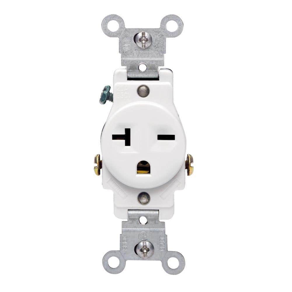

Other than wiring it the proper way, you can use one of these.
It has a a built in 20 amp breaker.
