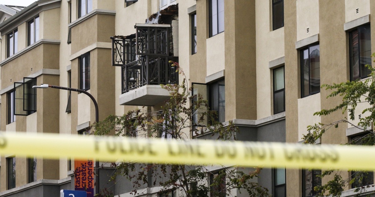

I can share many horror stories, and I even shared a link where contractors 'think it will hold'. I've tried to help you see the light. Nearly all of the structural failures I see are a result of being built wrong. And insurance companies use those findings as a reason to not pay on a claim.
