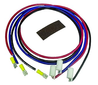

He didn't even try? Sure, it may happen again in a few years. I'd get another tech out to look. If the terminal is burnt off they make a repair kit. A burnt wire is a sorry excuse to condemn a compressor.

Pictures attached. It looks like the ground wire burnt off and separated. The other wires insulation melted a bit but still connected. The stud for the ground looks pretty roasted but I can try to clean it up. I don't see any insulation on the ground but don't know if that is the way it is. I can pull it back in the wrapper to see what's there. The guy disconnected one wire to keep it from running but i believe i know where that goes. Should I try new connections and see what happens? Should I solder the ends or crimping is enough?

I was able to clean up the terminal and put the wire back on using a straight pin connector for the black wire. The red and white seem ok. The compressor still isn't going on. The fan comes on strong but then slows down and runs slow. No codes. Not sure if I made that worse. If I wanted to check for voltage at the compressor how would I do that? Not an expert in 240v. I assume red and black are hot but where would I connect the ground test lead?
