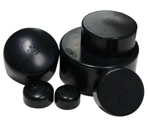

I would have put the sealer in the hole first so when the cut was screwed in the drain plane would be plugged all around it.
You could like use a 2 or 3" pipe cap.
