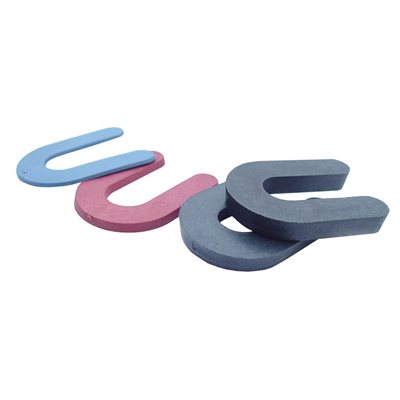

No you don't, you want the water to drain out, we set the windows on 1/4" spacers and the put 1/8 shims behind that bottom flange to allow the water to get out. And now they want a 1x behind the window to wrap up on a lip.
And now on the inside we see they are starting to put foam board behind the trim.
https://www.homedepot.com/p/QEP-1-8-in-Horseshoe-Shim-Tile-Spacers-150-pack-10321Q/205758793
