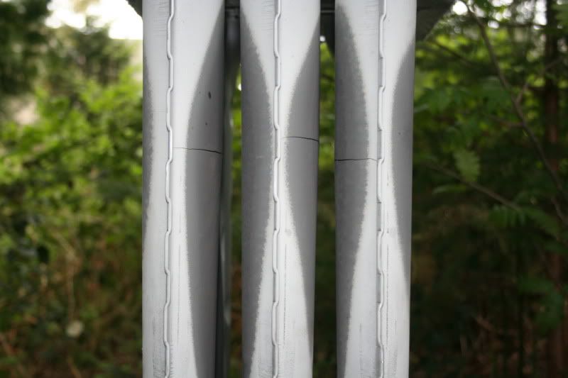

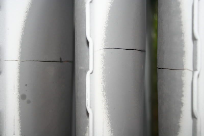

This heat exchanger came from an $800,000 house that the installing contractor botched, they not only botched this house but all others in the development. This 12 year old 80k BTU 3 ton furnace had 2 8x20 returns, both using only the wall cavity one of which was completely blocked with insulation. The supply duct was 10x11... This heat exchanger didn't have a chance. When I showed up for a maintenance I fired up the furnace and felt a massive amount of heat coming from the blower compartment, you could fry an egg on the firewall (downflow). At that point I was sure the heat exchanger was blown, pulled the blower and found the cracks. Anyway, just wanted to show the homeowners here what happens when you don't make an informed, non-price driven decision when it comes to your HVAC system, cracks like these are bad for your health!

I always do a visual HX inspection to confirm. I see what you're saying about the negative pressure thing but with larger cracks such as these I usually get a CO reading, why is that?
Administrator
42,396 Posts
What is the return like? Open slot for the air filter?
Next time your on one. Take a CO reading in the return in the blower compartment, and see if it isn't pulling CO in through the return. then also measure the CO in the return duct a few foot from the furnace. Will probably read 0 in the duct.
