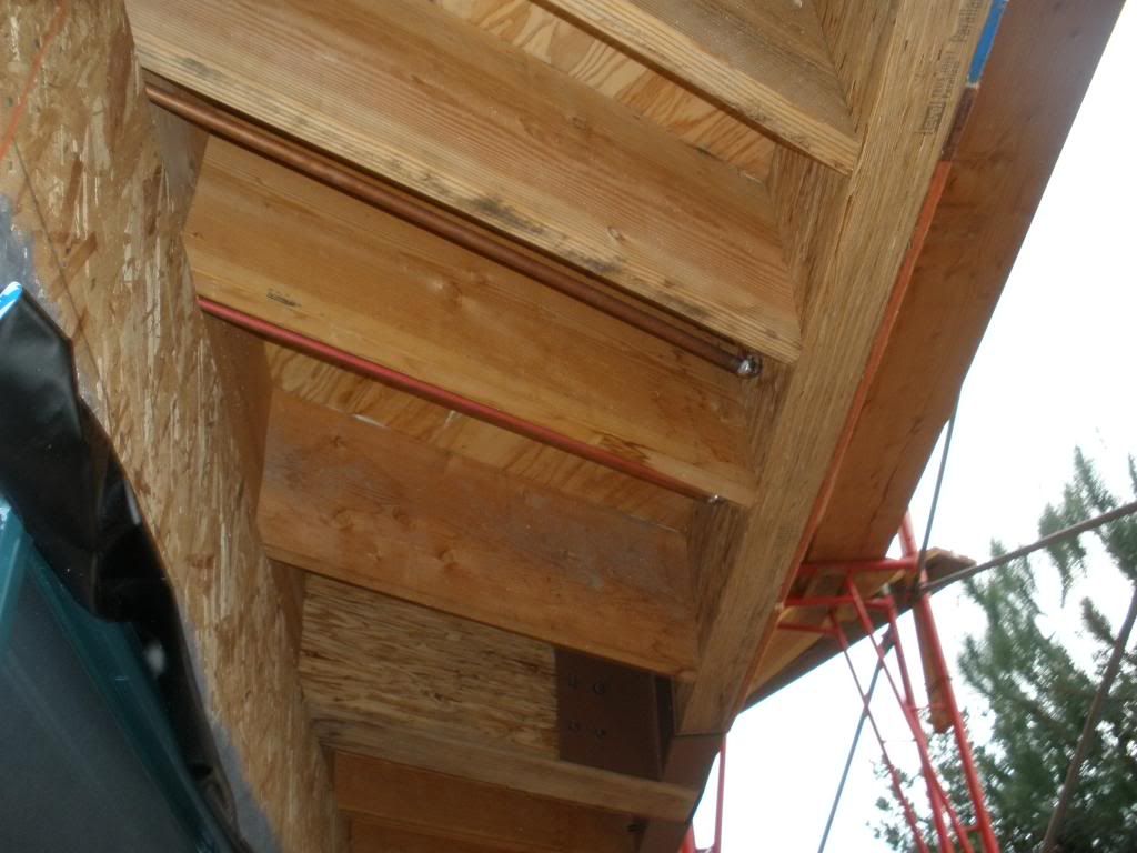

I have a 'slight' issue with how I attached my floor joits to the outside beam.....since it was only about 3' from the wall to the outside rim joist (3.5"x11.25" PSL)....and an odd angle (32.5 deg), I just toe nailed the ends of the floor joists. My architect says I need hardware.
Both pics are the same view....
Because of the odd angle....a 45 deg joist hanger does not work.....
Simpson has a squewable one....but.....it won't be easy getting it up there.
Would A35's (one on each side work)?
I'm ready to ask the architect but I wanted your guys input before I did....if you guys tell me to use the Simpson squewable ones...I won't even bother him with the question.

Why can't you just pressure block it?
What is a pressure block?
Remember....I'm a controls engineer who only knows enough about construction to get in trouble.....I'm going to need a little hand holding on this one....
· Administrator
14,387 Posts
In your case you’d block every other bay against the rim and then nail through the joist into those blocks, then fill in the rest of the bays. Much stronger than an A35 imo.
I don’t know of any adjustable angle Simpson hanger you can add after the fact.
The other option is to have hangers fabricated but I’d think that would be the last choice.
37,499 Posts
Go back and read all the info on all the brackets in what I posted. One should be close enough to make it work.
9,091 Posts
Talk to the architect if lag screws are acceptable substitute. Architect may want engineer's sign off.
Hangers are better than nails because they give support. Therefore, you may have to do the ugly and just beat one in there, and not worry about form fitting the ties. Take the closest then bend the parts necessary without compromising the basic "function" of the hanger, which is to support the lumbers. You must use 2x hangers, though. Anything wider would be compromising the hanger.
