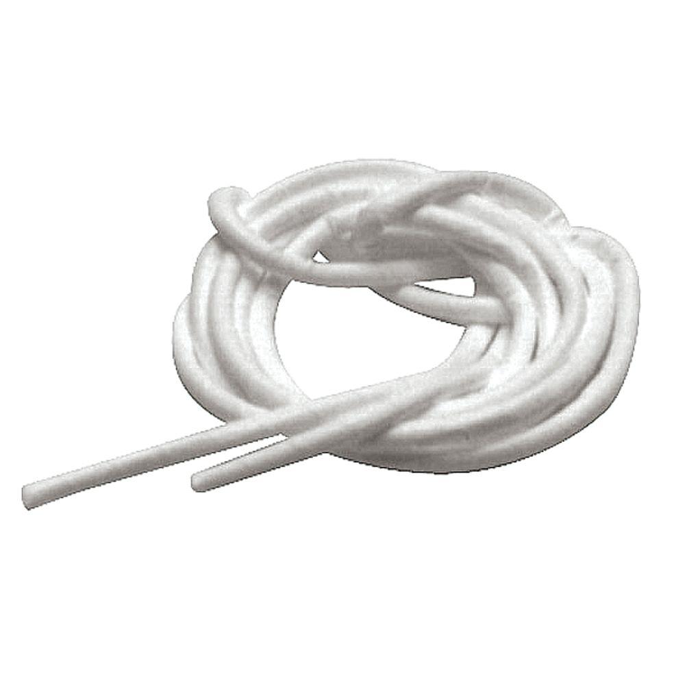

Where is it leaking from?
It is leaking from the green turn handle. Between the nut and the green turn handle. I have to turn it very tight to stop the leak. I have to use a wrench to tighten it and use the same to loose it up to turn the water on. However, just normal turning it off, the valve leaks.
Should be able to repack it.
Just an ordinary hose bib. Available at any hardware or big box store. May have a soldered connection inside.
If a globe valve or gate valve leaks from around the stem when turned off by hand the valve is leaking past the seat and needs further attention than the packing. That valve can be taken apart by unscrewing the bonnet after the water supply is turned off.
