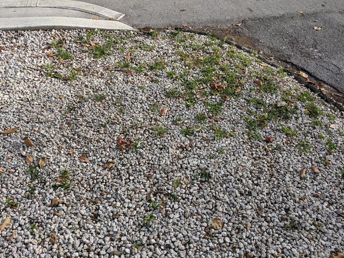

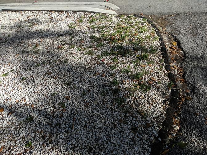

I have a driveway that is laid with about 2" of crush stones, it is an area about 80 feet long and 12 feet wide.
Weeds are coming up through the stones.
What kind of product do I need? I understand there are different weed control products like Round Up, or pre-emergent or post-emergent weed killer plus home made herbicide. What is the best option for my situation?
