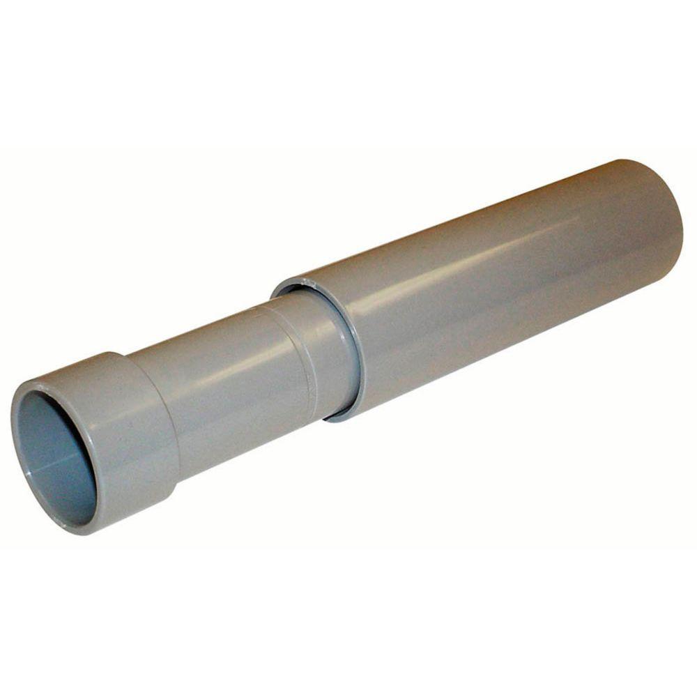

Expansion joints coming out of the ground would be required where I am located... I am pretty sure it would be required in the NEC also.
You only want to dig the ground up once, so don't be afraid to put in bigger conduits and a spare or two... Digging costs more than conduit does...

Expansion joints are used to compensate for frost heave, not increased burial depth.
Condensation will form in the conduit. That is why the conductors need to be wet rated.

I'm not sure I've seen these expansion joints were talking about.
Also yes I'm planning on using schedule 40 pvc conduit
