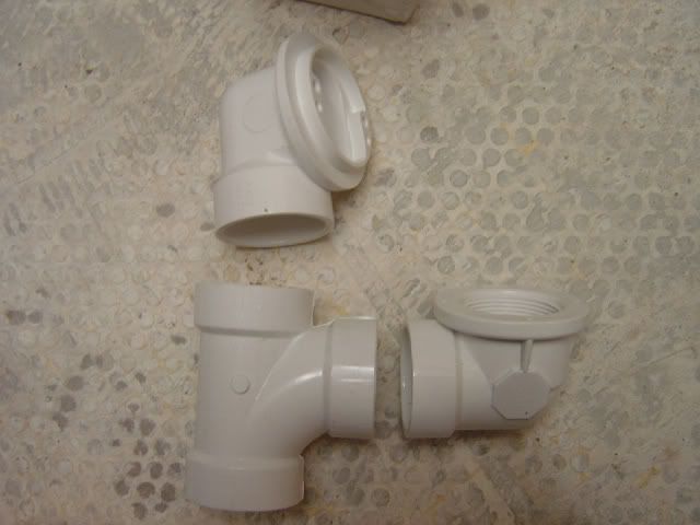

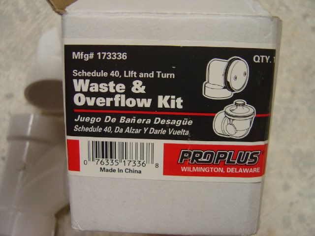

I'm in the process of remodeling the bathroom and wanted to know which....waste/overflow kit you prefer? PVC or Brass? Do they work the same? Does on have an advantage over the other?
Here's the one I purchased but wonder if this one is correct?

The tubs existing drain pipe to the P-trap is 1.5" brass or copper.. It has a male adapter on the cast iron p-trap and the 1.5" pipe coming up to the tub.
Install question?
How would I go about connecting the new pvc waste/overflow to the current brass/copper pipe that goes to the p-trap?
Would I have to use a boot since both pvc and brass/copper are the same size?
Would I have to remove the brass/copper male adapter at the p-trap and replace with with 1.5" pvc?
Was hoping there was a way for the pvc pipe that connects to the waste/overflow tee to slip into the drain pipe that's connected to the p-trap.
I hope this make sense, trying to word it as best as possible.
Your thoughts please..
Thanks
Joe
203 Posts
I would go with the pvc as the pvc won't corrode like the brass one does. If I was doing the job I would also replace the trap with pvc simply because for the same reason sooner or later you are going to have to replace that trap anyway due to corrosion so while you are doing it replace it. Use sch 40 overflow rather that a tubular one it is much stronger and willl last for years.
