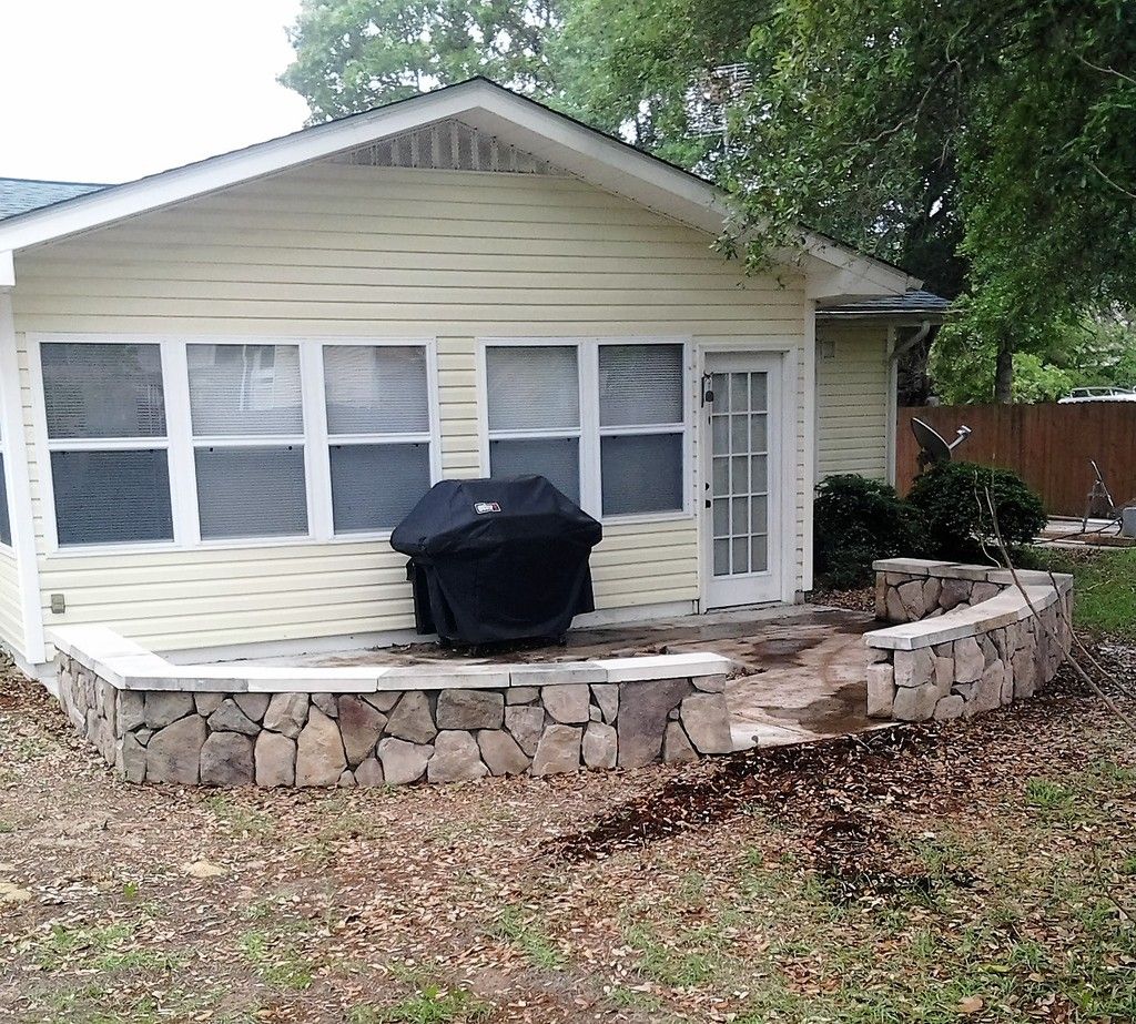

I just did a patio wall at the beach house with faux stone, so I believe your project would be a similar process.
Simple.
Using standard lightweight 8x16 block, two high, I used Liquid Nails extreme to bond the blocks together, then use thinset to set the faux stone on the wall, and topped it with some precast concrete.
Did the same at the main house years ago, and that wall is still standing firm.

I used the basic TEC Skill Set Ceramic 50lb Gray Powder Polymer-Modified Thinset Mortar From Lowe's for both installing the faux stone, and pointing, and it's held up well.
I already had the precast cement caps, and I used the same Thinset to bed them.
