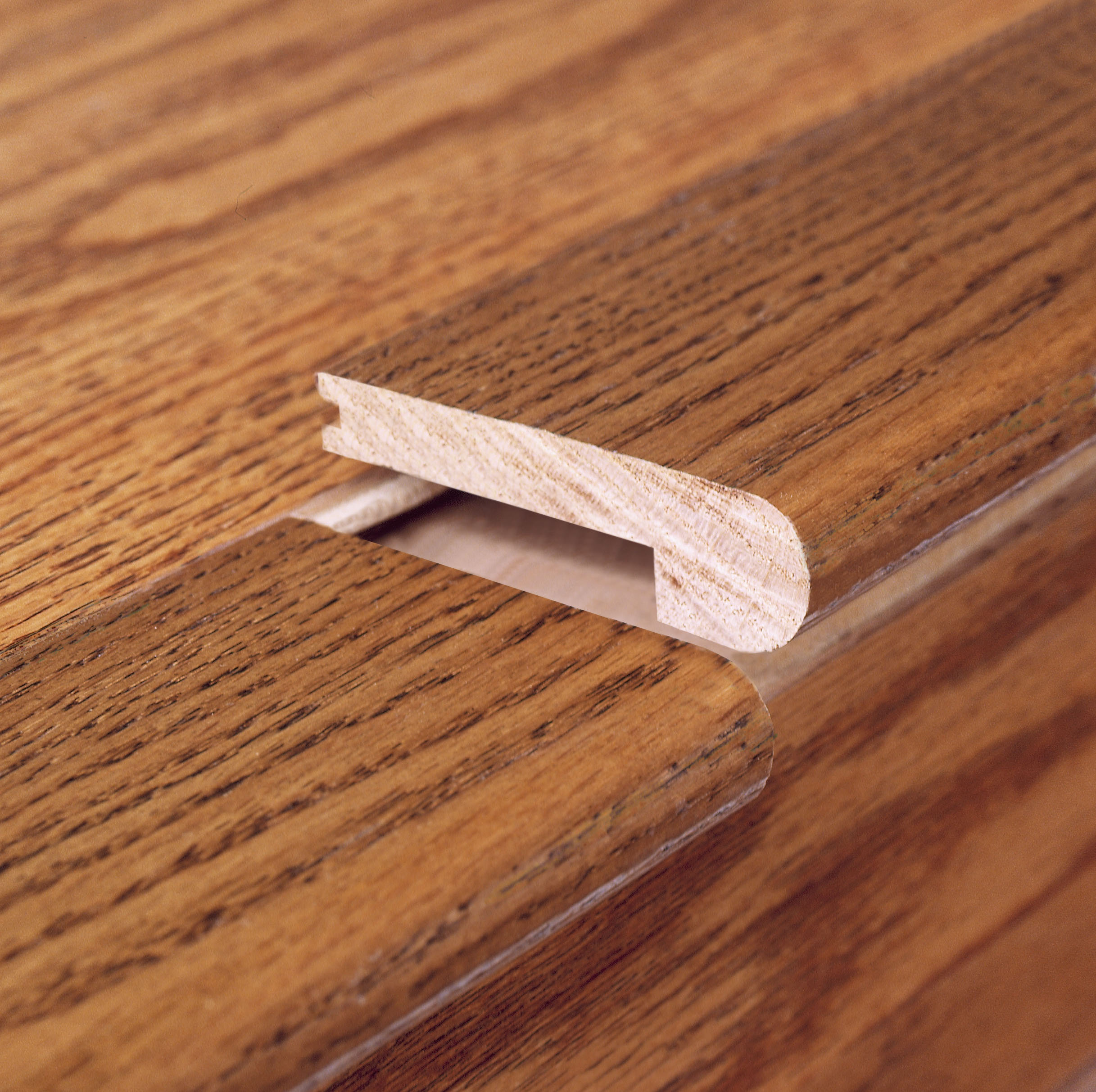

What is the "tread" piece called that goes on this large section of the stairs? Is it called a landing platform? I can't find something to buy that will match the treads I'm buying.

It is a landing and most everything that is sold for stairs has matching material for a floor even a small one like that. What are you putting on the treads?

Look at regular hard wood flooring and order nosing to match.

Does this mean I should use the hardwood flooring as the treads and risers? Instead of buying specifically made treads and risers?

I see that done when the have a landing but i think they get a thinner plywood for he risers, but I am not sure it might be the same hard wood.

So hardwood flooring for the treads, and plywood for risers?

Instead of just the stairs parts, start the search with flooring materials. General flooring includes staircase parts but not vise versa. Tongue and groove can be cut on a raw material but probably not worth the time when you're looking for prefinished parts.
