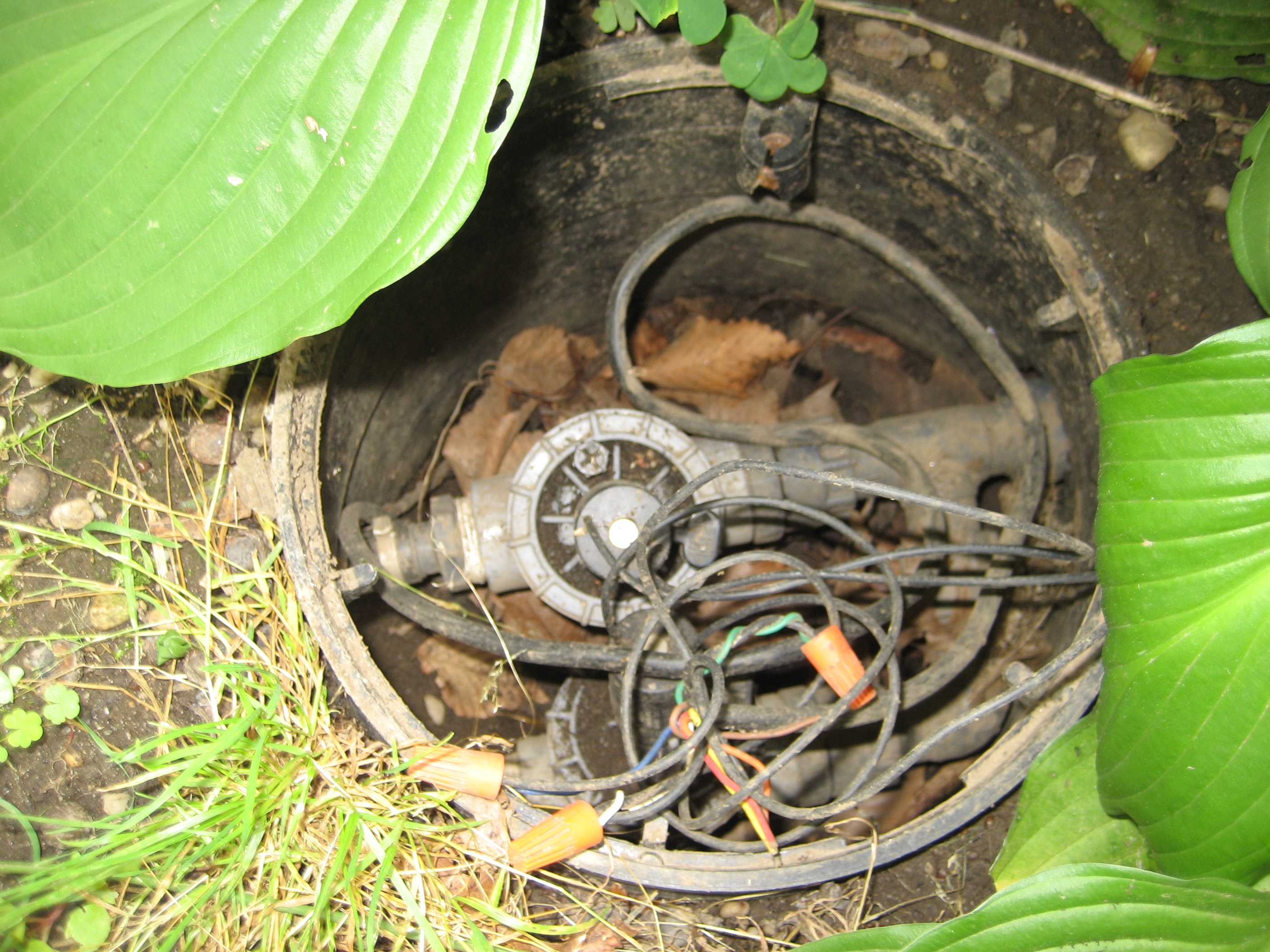

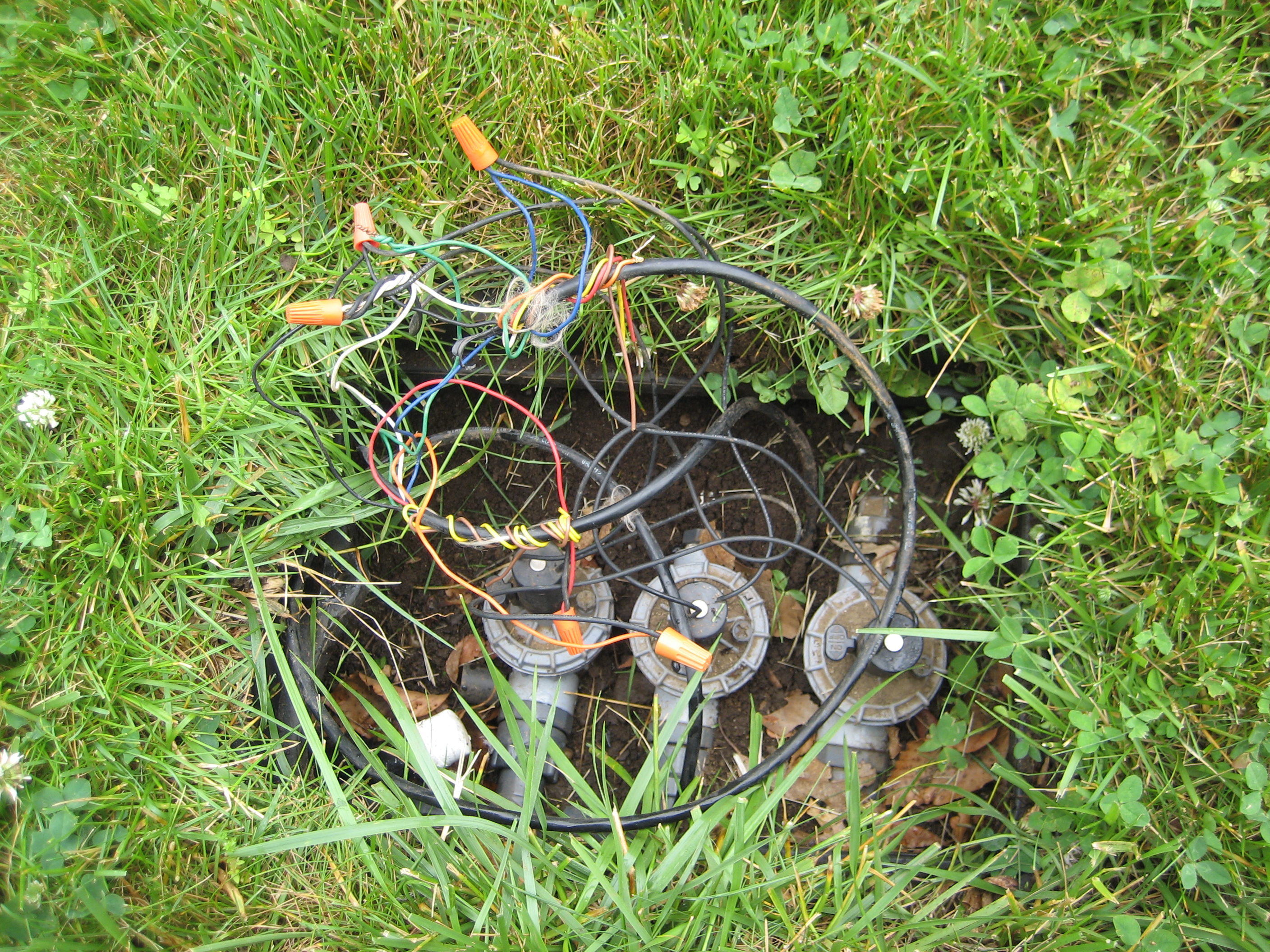

Here's a couple of pics.. I don't know how helpful they'll be -- the wiring is a mess.
I currently have valve B hooked up to the blue wire, so zone 4 works. When I first looked at the wiring, the splices for the blue and green wires had no wire nuts.
The white wire is also common, tied together with the black @ the controller.
Box in front yard. From left to right: Valve A, B and C.
Box in back yard.

UPDATE: I just whipped out my multimeter. Looks like when any zone is on, I get 24V between that zone's connection and any other zone. The zones that are off read 6 Ohms to each other.
So it seems that an off zone becomes a common connection.
If I hook up valve B to both the green and blue wires it should work. Does anyone see a problem with this? Don't want to burn out my controller sending current back to a zone connection.

It's been raining nearly every day here since my last post, so I didn't get around to testing things until today.
Connecting valve B to the green and blue wires did nothing (valve B would not actuate). I'm not sure why, as I was still able to detect 24V between the 2 wires when either zone 3 or 4 was on.
Any help would be greatly appreciated.. :help: Thanks!
PS - Sprinkler controller is Orbit model 57586. I can get pics of the wiring there later tonight -- my wife absconded with the digital camera.
