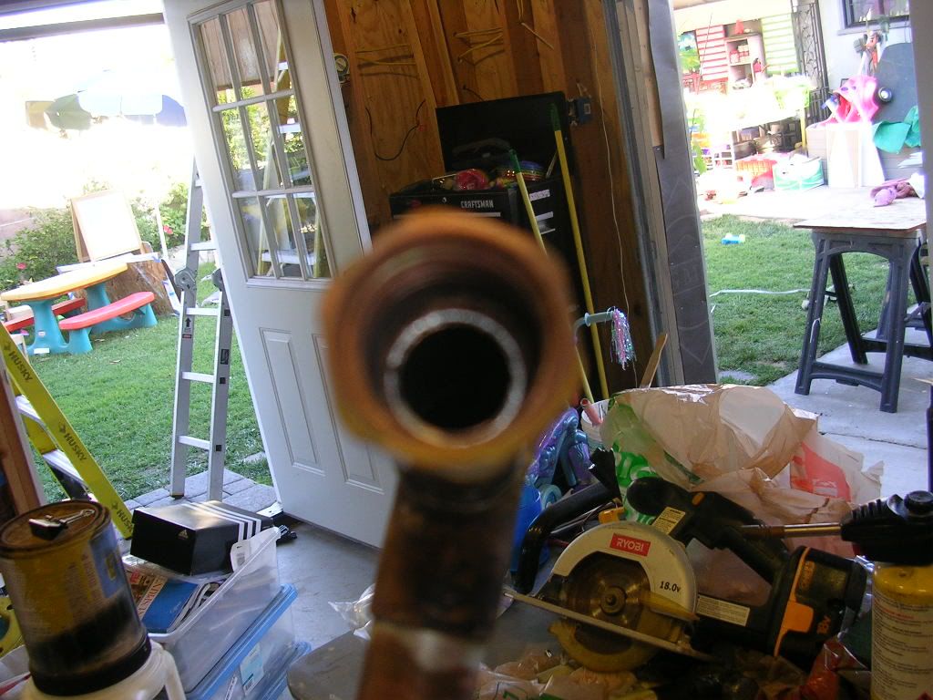

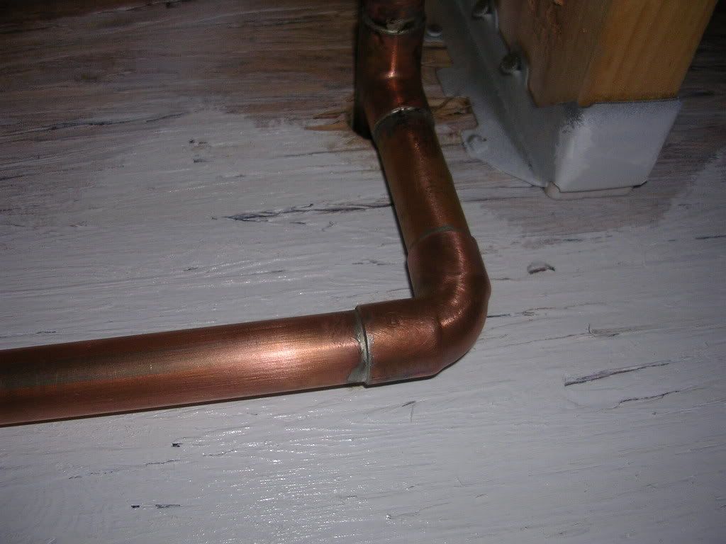

Heat......touch the solder to the part as you heat it. If the tip of the solder does not melt immediately, it's not hot enough. You will know when it is hot enough...solder will turn to liquid and get sucked up into the joint. You don't want so much solder so that it puddles, but should suck up into the joint.
When done right, you will see a silver ring on the inside that indicates the whole joint is flodded with solder.
Wipe with wet cloth.....this does several things. It sets the joint....it cools it off so you can handle it....and it cleans the excess solder and flux off.
