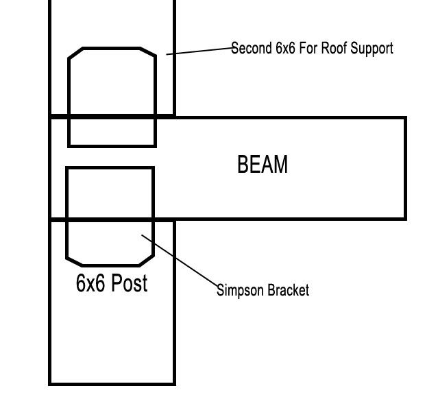

Alright, a continuation of options in my ongoing dilemma. ASSUMING my 6x6 deck posts are at 48" (below frost line depth for my area), with proper 2b base, and poured footers ended above grade with Simpson connectors, can I place a separate 6x6 post ON TOP of the beam in line of the deck support post using Simpson connectors and blocking into the deck joists? Diagram below:

That’s not how I’d do it.
Starting multiple threads on the same project helps nobody.
Extending the gable roof of your house to cover the deck is more than just a “side note”. :eek:
Building it may be easy but you really need a local pro to design this for you.

Apparently, you need help getting a good connection to properly transmit the vertical and horizontal loads on the roof to the rest of the structure below bwcause no information was supplied about the roof or othe connections (if any) to the home.
This is the key to the problem, but information is needed for relies and assistance. Nobody will bother without a good picture of the situation since it is probably not isolated from everything else. Details are for nit-pickers, but sooner or later you need more information to get a ral answer.
The retaining wall of the older style Versalok is nice, but it is a canned construction from the Versalok site and does not require any structural concerns. Why didn'y you cap the wall with the available caps or are you going to add on?
I appreciate that you do not trust anyone else to do work on your home, but when it comes to structural and safety, the answers will only be as good and the information provided. Little information will give nothing more than guesses and someone knowledghable would not bother without a better description.

Can you place a second 6x6 above the lower 6x6 post, resting on the beam? Of course you can. Will it be safe and meet code? Totally different question. If you are operating in a location where there are no codes, then all you need to do is meet your own personal standard of safety. On the other hand, if there are local codes and you need to meet them, this is a difficult problem, but not impossible.
Essentially you are building a post and beam structure. To determine if the plan is safe, you need to compute all the loads on the posts and beams, both vertical, horizontal and torsional, and determine that the structural elements and connections are within acceptable factors of safety. You are not likely to find the answer in a code book, unless your code book covers post and beam construction - my local code does not.
If you have enough structural background, you can compute all the loads, and determine all the factors of safety. There is nothing intrinsically unworkable about your idea, however the calculations do require more than looking up results in a span table. Pay particular attention to rotation at the connection point, and if you are in an earthquake zone, make sure the connections are flexible enough yet strong enough to resist the design earthquake.

The wall photo was mid construction. I've since added caps.
The roof will be supported by two 6x6s out front, with scissor trusses resting on the beams running back to the house. I will have the beams themselves resting on the top plate of the exterior wall of the house. The roof is a 4/12 roof, and I plan to obviously continue that pitch on out 14' from the house (it's a 22' span).
The source of the question of the post was to try to avoid having to set two extra 6x6s in front of the deck support 6x6s, but that's what I suppose I'll do. I'm going to have the deck cantilever 1' past the beam, so I will just run the 6x6s off separate footings on up through the cantilevered section. This will mean that below the deck structure, I will have two pairs of 6x6s 1' apart, and cosmetically, I don't like it, but it seems to be the only option.

You certainly like big wood structural members, but have to make sure the addition works for both vertical AND lateral loads PLUS structural continuity. Do you have anything for creating lateral support for your addition since it will see wind and lateral loads with a greater exposure?
Can you home roofing structure stand the additional vertical and lateral lods from the deck roof? All posts and beams is not good after you get up a foot or two.
This sounds like a job that can be done, but the bankers, code people, future owners (and their inspectors that know when to ask for permit proof) when it comes to selling.
