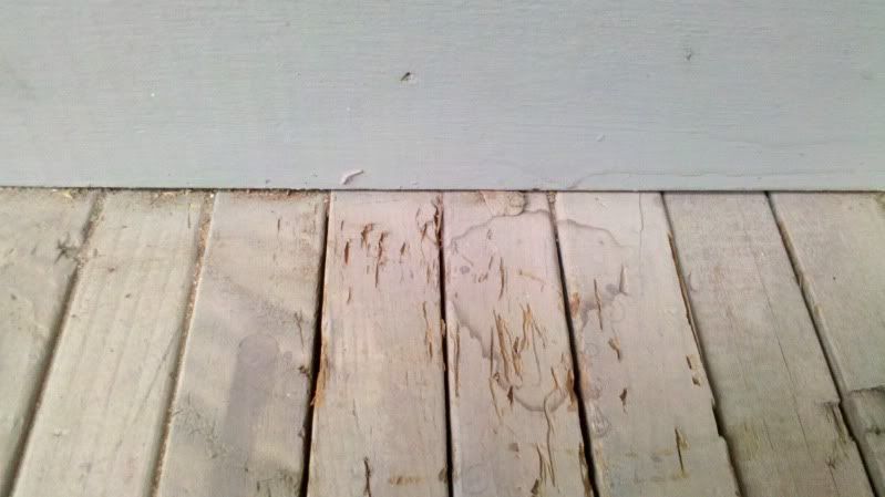

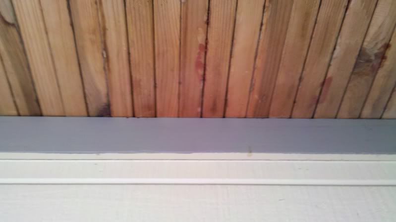

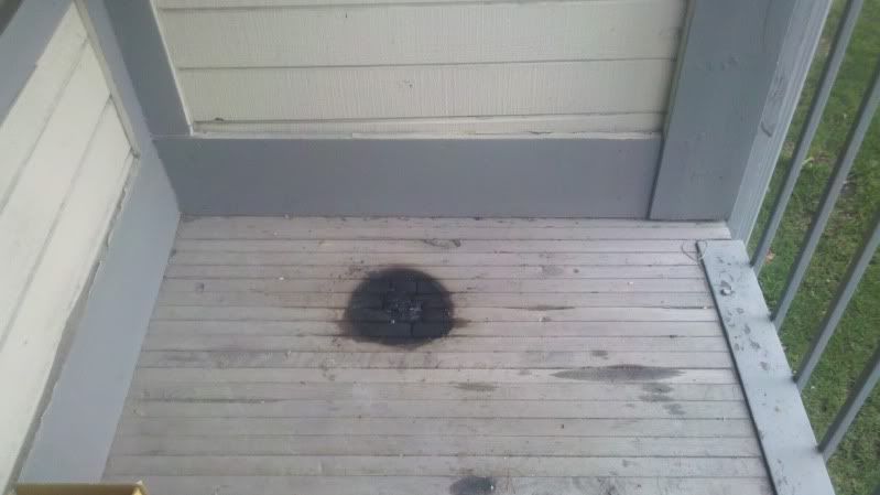

hi everyone im new here. stupidly i thought some coals were cold enough to set on a wood deck in a metal pan.... they werent. so now i got a big burn spot i can just cover up, i need to replace 6 2x4. they are nailed to each other skinny way which i have taken a saw and cut all the nails. on one end is a railing bolted down to the deck, i can take care of that side easy. on the other side the boards run under my house. well i have taken off the molding now and i have tongue & groove siding. behind that there is some 1x4 going vertical and behind that some board running horizontal. i am just renting this apartment and do not want to start taking 100 things off to replace these boards. is there an easy way to do this?
also, i cut one of the boards in half with about an inch gap, i can move the board up and down, but cannot slide it out.

If you have the nails cut between the boards and you remove the railing, can you just pull the bad boards out? From the pic it looks like there is just a ledger board underneath that the floorboards sit on against the house.
I would try that, you may not have to even touch the trim boards.
On a side note, that is an interesting way of doing a porch. Never seen it or thought of anything like that. Provides a neat look.

Pull the nails you see with the aforementioned cats paw. Sawzall the nails you can't see and remove the lumber. Replace as needed.

burn probably no more than 1/8 thick.....should have probably sanded and refinished.
since you've already cut nails, you now need to fix a structural problem when before you likely only had a cosmetic one.
this is based off an internet picture, maybe the burn is full thickness...:furious:
