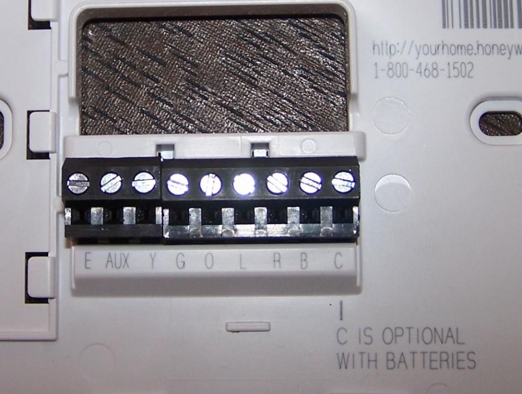

I am replacing a SimpleComfort 2200 with a Honeywell RTH3100C and need help with the wiring.
Here is a picture of the SimpleComfort unit:
And here is the connector for the Honeywell:
Can anyone help with the wiring? It's cold out baby!
Thanks!
Tom

R-24 volts (red wire)
O-reversing valve for heat pump (brown wire)
C-common (blue)
G-fan (green wire)
Y1-Cool (yellow wire, will go to Y on new stat)
All the above will be like for like.
W2-heat (will go to aux on new stat)
Turn the breaker to the furnace off first as you stand the chance of blowing a fuse, transformer or possibly the board.
