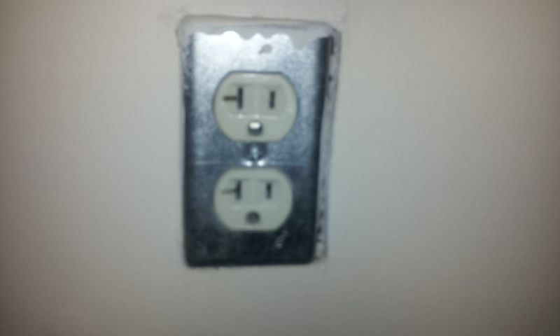

Ok i was going to add and outside outlet to my house and i was going to get power directly off an outlet from the inside. I drew a diagram on how the wiring was but i seem to have lost the diagram. I know it was stupid to have lost it but now i need help. I remember there being 3 cables coming into the box, two whites being plugged into the silver screws and one black to the brass. One black and one white was capped together. This is my problem i don't remember how the wires where connected to the outlet reciplcal and which black and white wires were connected together. There are two light switches (one above the outlet and the other on the other side of the room) that controls the outlets. It appears as there are 5 outlets and one outside light(outside light switch is above the outlet) that are controlled by this breaker.

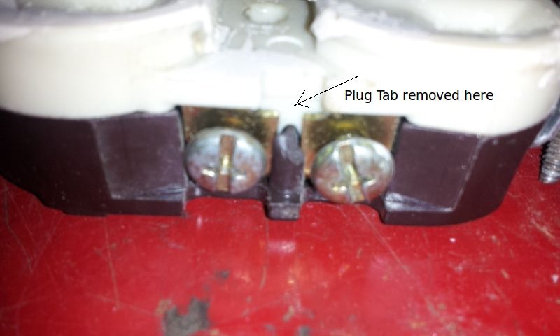

On a duplex receptacle, there is a tab that connects the screws on each side (the two dark together and the two silver together)
When an electrician wants to switch one outlet, normally he will break the tab only on the hot side, running one always hot to one screw ; and one switched hot to the other screw (on the same side).
The tap is normally left intact on the silver side and the 2 neutrals are connected to these 2 silver screws so they are connected together electrically.

No the tabs are not broken on the reciprocal outlet.
Here is a picture of the box. hopes this helps.
give me a moment.
Please post a pic of both sides of the receptacle.
I see 3 cables, and since none of 3 whites are marked as being a hot wire for a switch loop, you will have to figure out which one is for the switch (probably one of the top ones since you said one switch was above it) and where the other cable goes.
