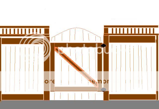

Anyone have ideas / suggestions / warnings / comments on what would be best? I'll give some basic dimensions and attach some crudely drawn MSPaint sketches to show the basic layout of the gate, if that will help anyone with a good foundation in structural integrity. Forgive the not-to-scale and floating pieces. I just wanted to give a visual layout for what I'm dealing with and would like to accomplish.
On the left is the garage that I can fasten into, and on the right is the house (The current gate a surrounding fence is tied into the walls already.) The 4x4's are each planted about 34" away from the walls (garage and house) and they are about 42" away from eachother. The 4x4's are about 60" high from the base of the concrete to their top. Here's a crude picture.
Here is a basic picture of what I'm intending to build. I would like to add some height to the fence, and make it look nice. The top portion would add another 12" to the top, or 18" if I start feeling adventurous. I'd prefer that the 4x4's go all the way to the top, instead of having to add height on top of the existing ones, but the amount of extra work that it appears to be needed for it seems quite high.

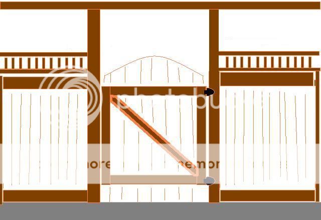

And again, in the moderately near future (next summer, probably the next tax return as long as nothing major pops up) I'd like to build a deck with a covering over this area, so using 4x4's as supports would be ideal, like this.
The roof would be ideally be about 9' high, and I can tie it into the house and garage as well, but that's a whole other DIY issue.

Well, until you got to the part about making the fence higher, I was going to suggest you just cover the posts with 1x. Extending the height of the 4x's is kind of an iffy thing, a saddle joint is about all I can think of to do that.
