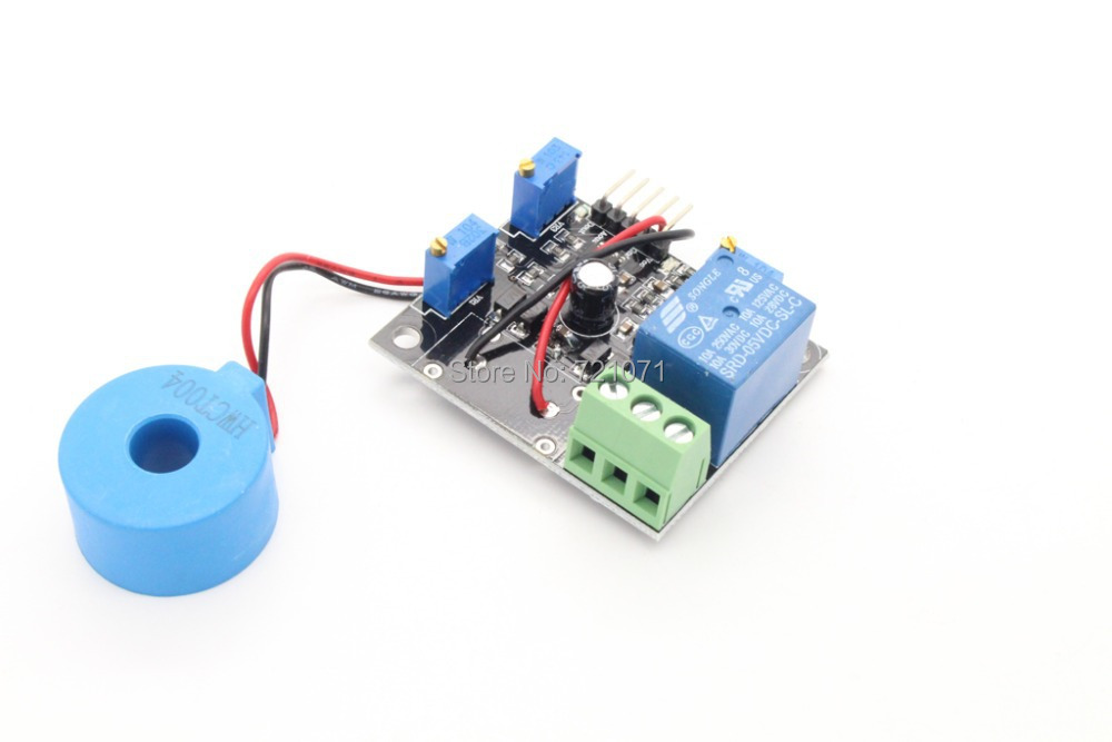

Is the electrical feed for the pump coming from your house?
You can always use a current switch. Mount your indicator in your house so you don't have to worry about not seeing it in the day. The current switch will sense when the pump is on and and activate your indicator.
http://www.ebay.com/itm/Current-Sen...415441?hash=item51debf1411:g:M2IAAOSw5dNWlze7
