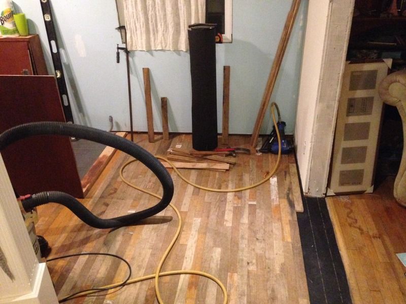

Hello,
I am redoing my hardwood floors. I will be sanding them down and then staining with Wood Finish Golden Oak Oil-Based Interior Stain link below and then poly with Semi-Gloss Super Fast-Drying Polyurethane for Floors link below.
I been researching online how to redo hardwood floors and everyone does it different. So my question is how do I do them so they are nice and smooth?
In my head I will sand with 60, 80, 100 (orbital), then 1 coat stain, then 1 coat poly - light sanding, then 1 more coat of poly?
Are there sealers I should use or others things im forgetting? I do have little dime size gaps through some of the boards that I will just fill in with the 100 grit dust and some squeaks that I will nail down. any help would be appreciated.
http://www.homedepot.com/p/Minwax-1...olyurethane-for-Floors-2-Pack-13024/202062678
http://www.homedepot.com/p/Minwax-1...l-Based-Interior-Stain-2-Pack-71071/202062711

I've done one floor....getting ready to do a lot more.
I pulled up flooring from where the kitchen is going to be expanded (tile will go in it's place) and I'm putting it down in my pub. Right after Xmas I'm going to do the pub, one bedroom, hallway and the dining room.
I've had good luck using the square pad sander.
There are two types of sanders....pad and belt. The belt is a lot quicker but if you are not careful, it will take off more than you want.
I just use the pad....start off with course and work my way up to fine.
It's one of those things you can't rush.
One of the most important parts....keeping it clean. After I vacuum...I take the leave blower or compressed air and blow it out...then vac again...then go over it with a tack cloth.
I use a hand DA sander for the hard to reach places and touch-ups.
Once the stain is down, you can locate any spots you missed....sand and re-stain.
When it comes time for the varnish....I can't stress how important it is to be clean. When you think you have it clean....clean again.
I'll be sending the family (and dog) over to the in-laws for a few days while I'm dong the floors. I'm going to be doing about 600 sq ft so I have my work cut out for me.
Side note....once I have it sanded, I wear a cheap pair of white socks. They pick up any dirt and if I have 'any' missed nails or splinters...they will find them.

So the process is sand, stain, poly, light sand, poly?
533 Posts
I agree with the guys who answered your post essentially suggesting this is not a DIY friendly project especially if you are living in the house. If you just have to DIY here are a couple of thing I learned from the experience.
Remove everything from the room or rooms that ain't nailed down. Take out any trim touching the floor, you will probably ruin it anyway. Rent a orbital or even better square pad sander, NOT a belt sander. Buy or rent a hand held sander to get the edges and corners even it you think the square pad sander will do it all.
Start with 60 grit, stay away from 40-50 grit, it's to aggressive for a beginner. Then 80, 100, 120. I know some would go to 140 but I feel 120 is fine enough. This is important - thoroughly clean all the dust and grit before moving onto the next finer grit. Vacuum, blow, vacuum, vacuum again just to be sure. Every little piece of grit left behind will create scratches. Extra cleaning pays off every time. I use a HEPA filter on a shop vac which helps later in the process. They are about $40 and well worth the money and most of them are washable.
Sealer? Maybe. It depends on how the wood takes the stain. I figure it can't hurt but I did not use one so I really can help you much on that one. Stain as evenly as you can and correct any problem areas before moving on to the finish coat. Finish will not hide any problem they will make them standout, keep that in mind.
If you think you are all cleaned up and ready to apply the finish, clean again. Figure out a way to stop the dust, blocking registers and returns, plastic on entryways turn off the furnace, run a couple of air filters for a day before you apply the finish. What ever you can do to eliminate dust. With a high gloss finish dust is your enemy. Consider a satin or at least semi-gloss. It is a little forgiving and help hide some of the "character" your floor will develop with use.
Things to consider before you put all the work into it. A pro will be finished in a few days, it might take you a few weeks. I only saved about half of what it would cost to have a pro do it and about the same as what a new DIY pre-finished floor would have cost. When all said and done I felt it was not worth it. You will have places that are not perfect so be sure you can live with that, even the pros are not perfect but somehow it's easier to live with. Keep in mind, your family and friends will walk on this floor and not understand how much work you put into it so make peace with that before cousin Eddie drops his pocket knife on it or your son's hot girlfriend drives a divot in it with her heels.
Please post pictures of your progress if you go ahead with it. Whatever you decide good luck.

So I don't want to rent a buffer to do the light sand. Can I just use an orbital floor sander with 220 grit instead of a screen on a buffer?
Depends on how large the area is. That could take a long time.
I'd rent the sander from HD. The time saved is worth the money.

So i cant get 220 grit for the 3 disk orbital sander. The finest I can get is 100. When I coat with poly can i just use the 100 grit quickly to texture the floor?
207 Posts
you'll most likely need multiple coats of poly. and you'll quickly learn why poly is rarely used by any professionals who finish wood outside of flooring. poly is very slow to dry, and to make it "fast drying," they reduce solvent, making the solids content go up. hopefully, your very patient in letting the coats cure.
imo, 100 grit is too corse between coats of finish, but it is only dependent on the eye of those who are scrutinizing.
finally, a warning that oak is a terribly difficult wood to finish. I'd stick with a gel stain or a pure dye stain which has no pigment.
3,094 Posts
In between coat sanding can be done with a drywall sander like this one
The old style rectangle kind will work too, they're just not as easy to use. Put some 220 on there and sand in the direction of the grain. The three orbital floor sander you'll be using is overkill and too aggressive for the in between coat sand
You could also do it with a regular 5 inch random orbital sander.
412 Posts
I refinished some hardwood stairs, a landing and a very small office recently. Between coats I used a drywall sander similar to what Jmayspaint showed (and just a sanding block on the stairs themselves). I believe all you are really trying to accomplish here is to knock down the dust nubs. All I gave it was a very light sanding.
I'll also warn you that I've not generally heard good things about Miniwax products from those who know more about finishing than myself. I also don't believe in staining wood, but that is a personal choice. (FWIW I used Bona Traffic over Drifast sealer, but I'm sure there are many options that would work well here).

what benefit would the gel stain have over the liquid stain?
533 Posts
I did not find it necessary to sand between coats. I believe sometimes you will have the fibers in the wood lift and sanding is required only after the first coat. If I did need to sand I would not use 100. As Jmayspaint suggests a pole sander and 220 is probably the way to go. Do not use a power sander for sanding between coats.
If you minimize the dust and re-coat within the recommended time you should be O.K. If you have days between coats you may need to sand for proper adhesion.
