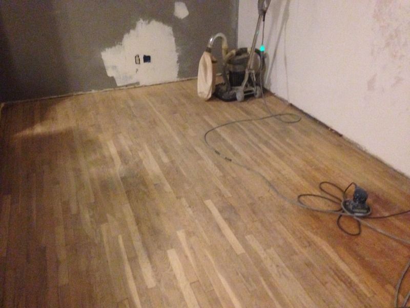

This is one of my floors after sanding but before stain

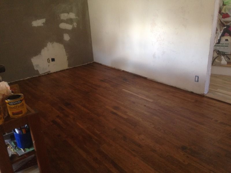

And after stain - MinWax Provincial
