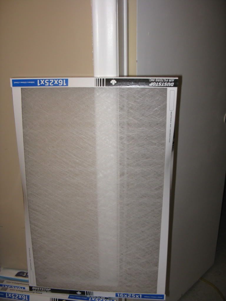

I bought a new furnace recently and I was told by my HVAC guy (who i trust) that I should use "cheapie" furnace filters during the summer as it lets in more airflow, but use the good filtrete style during the winter.
The filter I replaced that he installed was fibreglass, with a metal backing. The only fibreglass I can around here at most stores exept L**es are "Duststop" ones and I can see right through them. are they too thin? Another cheapie type I bought was at lowes, it is very thin, made of paper, "AAM dustshield". Do thin paper filters ones have considerably less airflow than a fibreglass? I want to do the right thing
please advise. I want to know if I should never use those filters for any reason. I don't like using cheap products that ruin expensive equipement
pictures attached

Discussion Starter · #16 · (Edited)
I ended up going with a dense fiberglass with metal backing filter for the good airflow. Picked it up at an HVAC supply store, around $2.25/piece. The one in the picture had no support (metal) or was not waffled (for support). I will use the fiberglass in the summer, and switch to a merv 6 or 8 midrange filters in the winter after I use up the filtretes I currently have, unless I should not use them at all? strangly the second filters, advertised as 1" thick were actually thinner than the other ones for some reason. 13/16" weird, i am hesitant to use them.
Thanks for the info.

I would use the Merv 8 all year round, dust knows no season. To make it safer for you start the AC with the Merv 8 in. Then go outside after 5 mins and put your hand on the large copper line (peel back a little insulation if necessary and tape it back later. After 5 mins it should be cool or cold and/or sweating and what we call Beer can cold. Then run the AC for a full half hour and recheck the line. If it it white and icing up then the filter is slowing the air down too much. If it is the same temp as B4 you are perfectly safe to use the Merv 8. Check it after another hour or periodically if it makes you feel safer. You should also get the freon level checked and the tech can verify the filter is OK. I sell nothing but Merv 8 and 10 filters to my customers and some high end Merv 16 Hepas to the rich folks or allergy sufferers.
