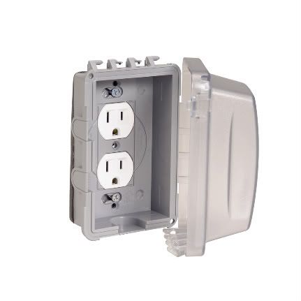

About a week ago I asked about what wire I needed to run to an outdoor pool pump and got that part all taken care of thanks to the guys on here. I mounted a single gang pvc box to a fence post by the pool, ran 3/4" conduit from that box to the garage with a LB and then pulled 3 thhn wires threw this. Now I need to finish getting power out ther and have a few question. I have a sub panel in my garage where I will be getting power from. This is my plan so tell me if I am good or need to make some changes please. From the panel will be 20 amp breaker, 12-2 romex to a junction box attached to the LB. In this junction box I will go from romex to the stranded wire that runs to the pvc box by the pool. I bought a 20 amp GFCI for the box and a weather proof cover. The question I have is in my question about the wire someone mentioned the gfci has to be before the wire goes into the ground. So should I put the gfci in the junction box in the garage and then another out by the pool? Or a gfci in the garage and a regular outlet by the pool? Thanks for any help with this.
1 - 19 of 19 Posts
1 GFCI is all you need.Put the GFCI in the junction box in the garage or get a GFCI breaker and a regular outlet by the pool with a In-use cover. Put the GFCI sticker on In-use cover.
Thanks 300zx, I'll see how much a gfci breaker is and probably go that route just for ease when it trips. I do have an in use cover so the cord will stay plugged in and the pump has a timer.

Use a short piece of PVC from the LB into the back of a 4 square deep box/single gang mud ring, mounted in the garage wall. Install the GFCI recep in the 4s box.
Use conduit (instead of NM) from the panel to the 4s box and you will have future accesss from panel to back yard box.
