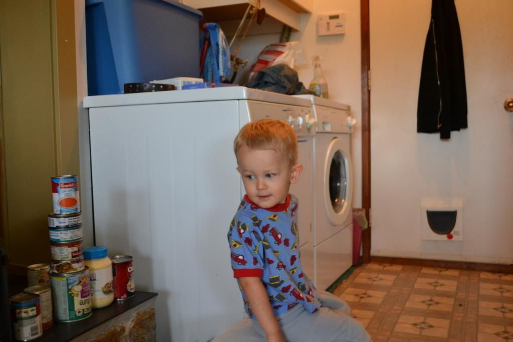

latest project was the laundry room. Its right off the kitchen, it had a large sliding glass door.. But the track broke so I had to remove it. We didnt take pictures of the room before we started but this will give you an idea of what it looked like!
I framed the wall in to allow for a regular 32" door, then put a new sub-floor and tile down. The counters are built with 3/4" plywood with 3/8" granite tile on top. the nosing aren't finished yet. just did the cabinets and counter last weekend.
