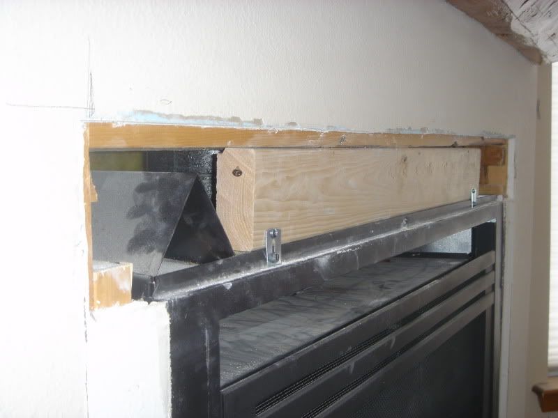

Found that there was nothing supporting the drywall behind the top of the fireplace so had to 'attach' some 2x4 in there and redo the drywall.
