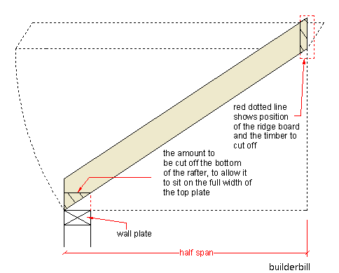

18' length may equal 14' actual span
You are looking at maybe just over a 2x8 to get a 14' span for a rafter
The Span is the distance between the inside wall & the ridge
labelled "half span" in this pic
