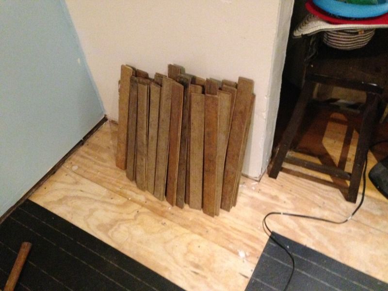

I'm in the process of putting back down some oak flooring that originally came with the house.
Originally the oak was nailed to 1x6 planks (sub floor)
In those places where I am putting it back down, I put 3/4" T&G plywood down on top of the existing sub floor...and then the oak.
No squeaks...nice and solid....quieter (you don't hear the thumping as you walk).
Overkill? Maybe...but I'm happy
