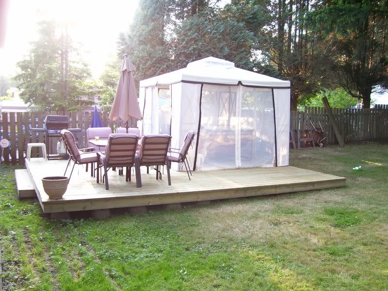

What is the measurement from ground to stairs? I have small 10x20 deck built "floating" on skids, 2x6 joists on three 4x6" beams, rock solid. Not attached to the house and set off a few inches for frost heave reasons.
