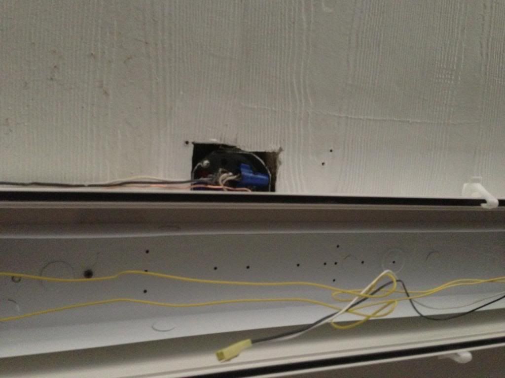

Im trying to mount my new fixtures and the *******s that put the old ones up cut a big ass square hole for a round box. Also, because of the way the joists run, I need my new lights to mount to STRUCTURE. The old ones only mounted to structure on one side and on the other they just screwed it into the hardboard. Not cool.
ANyway, this is where my new fixtures are and where they need to be. I need to pigtail out of that box and get around to the inside the fixture. How in the world do I close up that hole? If I need a cover, its going to have to be WELL oversized, by about an inch on all sides, and need to be thin to slide under the fixture. Also, it needs to be friendly to wiring to go through.
What's the solution? I would like this to be to 'code', but if thats going to be a pain in the ass or expensive, then I want to do it to 'whatever looks best and will work safely'.
Thoughts?
I have EIGHT like this.
I can't mount the light over that box and the wires need to come in through the end, so they will at least be partially exposed even when installed. Im ok with this if its OK.
I cant move the fixutre over the hole since its mounted to the side of the structure I need to attach my fixture to.

A couple toggle bolts will hold that right where you need it to.

Could you clarify a couple of things?
Are these lights mounted on the exterior of your house? On a vertical wall or ceiling?
I'm not sure why you can't move the fixture to fully cover the hole. That is typically how lights are installed. They either cover the hole with a housing or the fixture itself.
When you say the fixture needs to be attached to the structure do you mean only to a joist or stud? There are many adequate anchors that would allow your to support the light from the "hardboard".

This is on the exterior of my home, under a covered car port. My joists run parallel to the light installed and the light is mounted with TWO single 2" deck screws directly through the housing into the cieling joist.
Are toggle bolts the correct means of anchoring this fixture to the hardi board that's 1/4" thick?
ALSO..these are vaportite fixtures. Can I break open the knockouts in the interior metal portion and drill through the fiberglass housing and put one of those threaded wire 'clamp' things in it and simply caulk it heavily once installed?

Putting it further away will put the lights far too close together to light the edges. My only real good option here is to cover the box completely, which is what I want to do. But it will require cutting a hole through my vaportight fixture and using a knockout to gain access to put the wires through. This is OK I assume, provided I caulk the area and return it to its vapor tight status.
If I used conduit and moved the lights, it would require a cover that was big enough for a dual gang old work box, and that would look terrible. Ill look around.

Remove one the the knock out in the back. Use a bushing or close nipple to protect wires. Place light over outlet box mounting with toggle bolts. It's up to you whether you need a vapor tight light. Not required by code in a carport.

That's exactly what Im going to do. The vaportight was partially bought to reduce dust and bugs.
