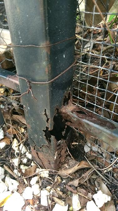

I have a metal fence in the front portion of the property. I am pretty sure it's iron because it's quite rusted LOL. The fence is 6 feet tall with posts about eight feet apart.
According to the city it was permitted and installed in 1992. So it lasted 27 years. It rains A LOT in South Florida and occasionally the front of the property and the street gets flooded with storm water. Over the years the metal posts rusted, and rusted, and rusted at the base.
I have about eighty feet of this fence, and twelve posts rusted to varying degrees, this is probably the worst one. The posts were set in concrete, but the concrete was lower than the ground.
I am looking for suggestions to REPAIR the posts.

One option I have been thinking about, would be to cut the top of the fence post cap off, then insert a round aluminum pipe with an OD just smaller than the square tube fence post. Then try to pound the pipe into the ground and hope that it will go down and past the rusted section and further down as far as it will go, then I can weld the outer metal tube and the inner pipe together at the bottom (where the rusted out section is) and weld back the top again. I have no idea if this will work.

....insert a round aluminum pipe with an OD just smaller than the square tube fence post. Then try to pound the pipe into the ground and hope that it will go down and past the rusted section and further down as far as it will go.....
That would be steel, not iron.
But if the post is set in concrete, how are you going to pound a pipe into it ?
If the concrete plug is reasonably flat and large enough diameter, new posts could be built with a square flange at the bottom, with four holes, that could be anchored into the concrete. Replacing rusted sections from the fencing is probably no big deal to an outfit that builds that type of fence ---- it won't be cheap, but not a big deal to have it done.
Or... Put in new posts, 24" offset from the existing posts. Would work best if the last posts could remain. Means cutting up at least one 8' section into a 2' plus a 6' section.
I may not be able to. It depends on whether they poured the concrete, then dip the post into position, in which case it will be filled with concrete inside.
However, if they position the post first, may be holding it this way and that to check for level and plumb, then have someone else pour around it, then there is a chance the middle is mostly hollow.
They will not let me put a new post between each pair of posts. Said that's not a repair. That doesn't mean I cannot do it, one at a time, weeks apart, quietly...but I would like to consider all options first.

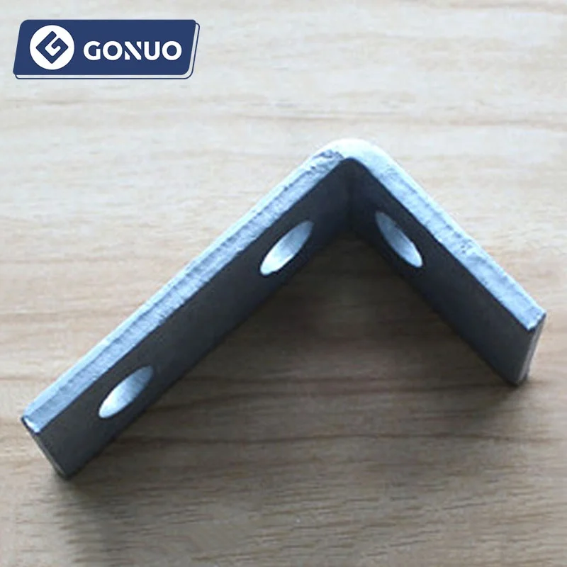

drill and epoxy the rod in the concrete.And find some long angle brackets to attach the bars
Nealw, thank you, just to be clear, you mean to find some long L bracket/angle, to do the same thing the HDU5 part is doing to the wood post in the picture above? It would need to be a long angle to get to the good metal? If I do it this way I wonder if I need to do it on two sides? all four sides?
Side to side will be fine if the fence is attached to the post. I was thinking a block or something under the bigger bracket and you might need 2 of those.
They come in a bunch of sizes and shapes so you might find one that would do it with one.
An iron works shop could make up the angle brackets for you.
