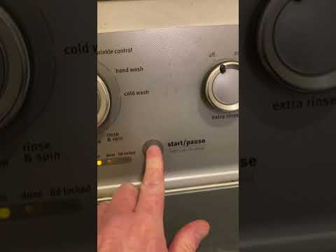

Hello All,
I have a Maytag Bravos washer that is making an unusual sound during the spin cycle. I’ve searched everywhere to find a video online that matches this sound hoping to diagnose it and can’t find one. Here is a YouTube video I shot that plays the sound mine is making. I suspect it’s a belt but wanted to see if anyone else is familiar with the sound that might be able to confirm for me. I’d appreciate any help.
Thanks,
Jason

Sounds like a grinding noise to me. Maybe bad bearing somewhere, either with the tub or transmission.
Spin the agitator/washplate fast by hand and see if it spins freely and smooth without any noise. Post results when done.
